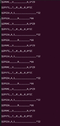

Hello, we started some tests with the RM520N-GL modem with the YEMN016AA antenna and we have a GNSS fix and 5G connection.
Now, when running the same exact procedure and tests with a RM520N-EU (revision RM520NEUDAR03A07M4G
) and the same antenna (from ANT0 to ANT4), it does not see any satellites.

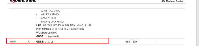

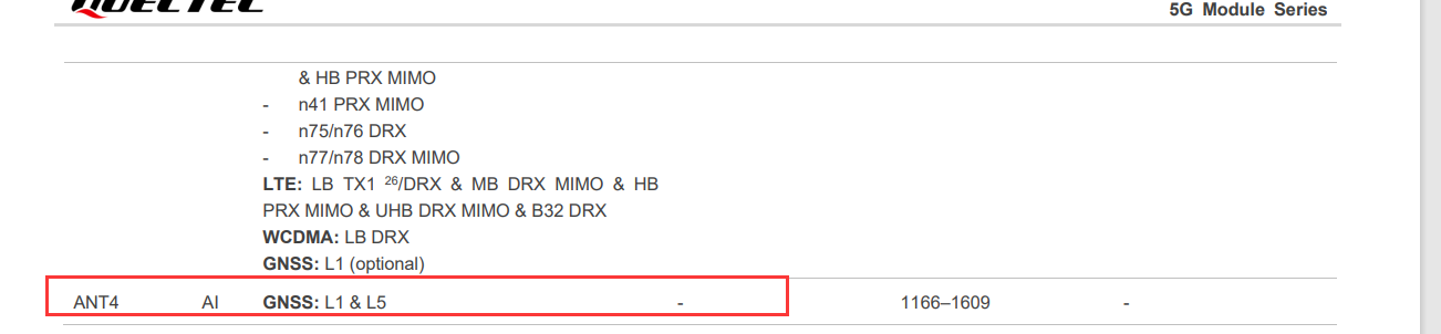

Dear @niwuniwak
For RM520NEU, GNSS is ANT4, please check your antennas.
I checked the antennas, they are indeed plugged like your specs, with the GNSS wire of the antenna on ANT4. But not satellite visible, no GPS time, no fix. I wonder if we have the right firmware or if there is an additional AT command to use this modem.

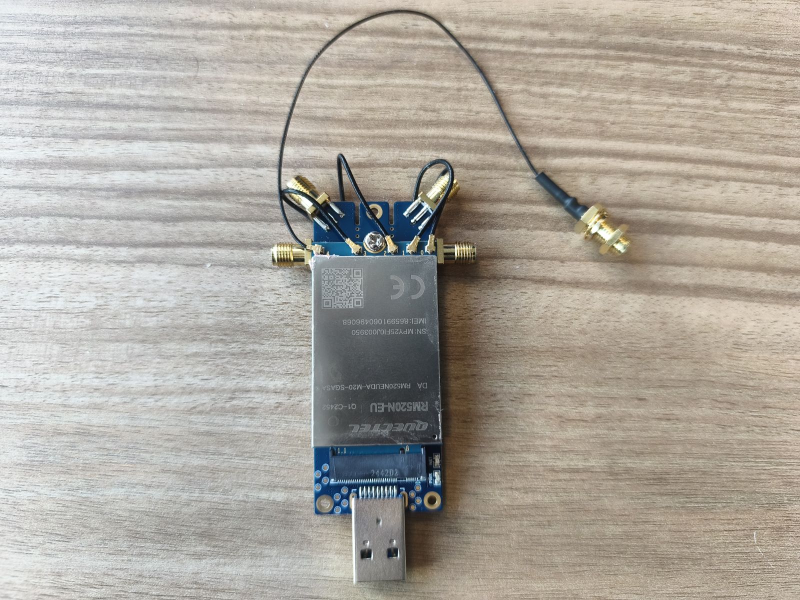

Please share a picture of your RM520N-EU.
Here are the pictures of the modem, in the M.2 to USB interface.

It is strange, do you test in open sky?
Yes, the antenna is out of the window, with the top facing the sky. With the same antenna and the RM520N-GL modem we have the satellites, but not with the RM520N-EU one. I wonder if we have the right firmware or if there is an additional AT command to use this modem.
