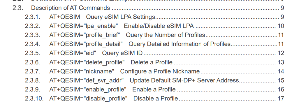

I have a RM520N and I need use eSim.
Can send the LPA Software or working instructions for install a profile?
Command AT+QESIM=“add_profile”, “###” returns “Comming Soon”.
What does this mean?
It’s possible add a external eSIM (like as ST4SIM-200) ?
How should the profile be transferred?
Sincerely:
Jaime Luján.
Dear @Jaime
Due to some limitation, I can’t share this to you via Forum.
Please contact with your provider to get LPA software.
Currently, it doesn’t support AT+QESIM=“add_profile”.
