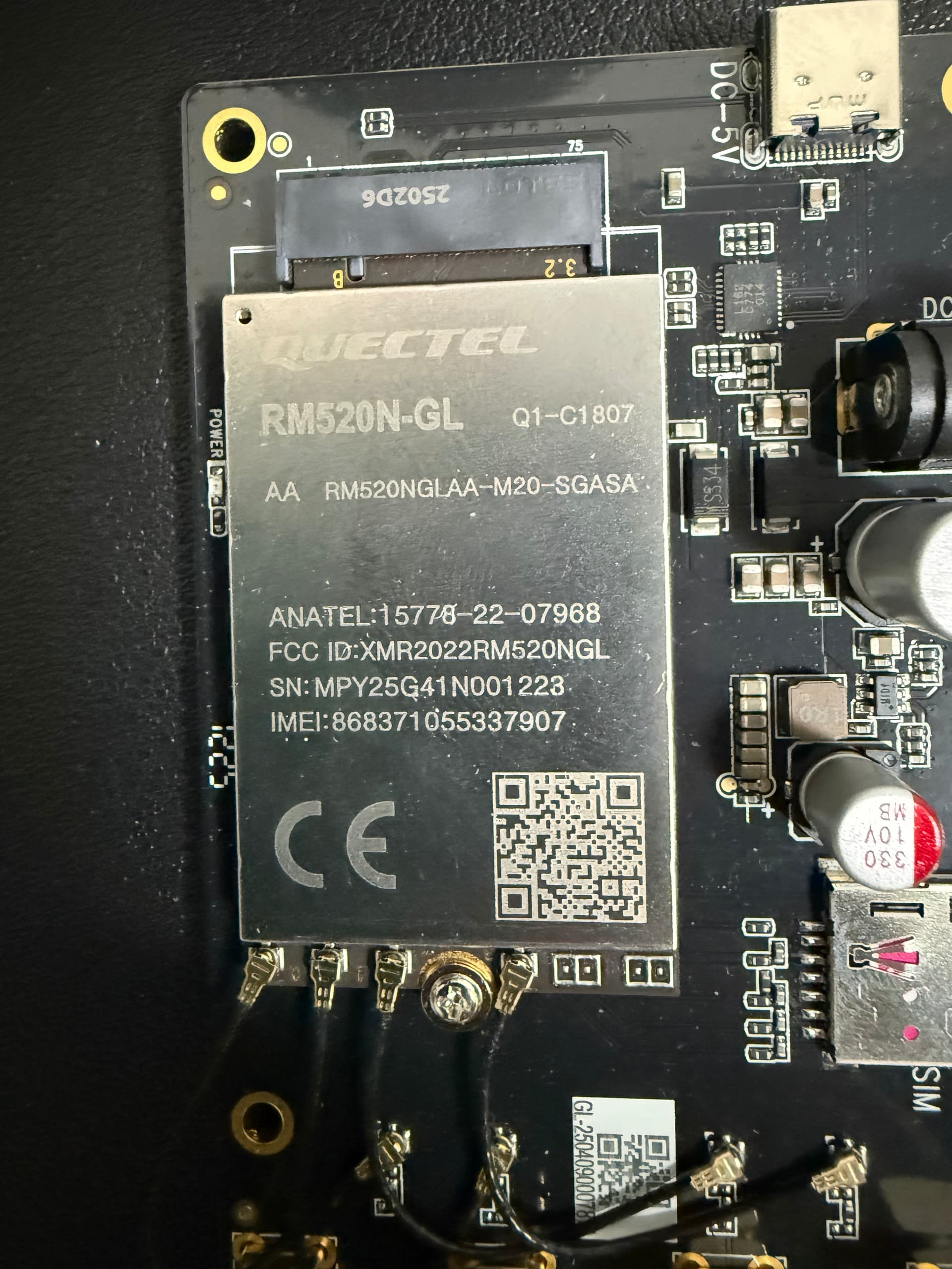

Please share a picture of your RM520N, I need check the information in shield cover.
Thank you for your reply.
Please find the attached picture of my RM520N-GL module with the shield cover information.
Details from the shield:
  • Model: RM520N-GL
  • Variant: RM520NGLAA-M20-SGASA
  • SN: MPY25G41N001223
  • IMEI: 868371055337907
This module shows the same issue on different boards and PCs:
  • AT command not responding
  • Device Manager reloading continuously
  • AT and DM ports exist, but AT cannot be used
Please let me know if you need any additional information or logs.

Dear @Phuc_Tr_ng
Device Manager reloading continuously seems the module was rebooting.
I have sent the firmware to you, you can try to upgrade.

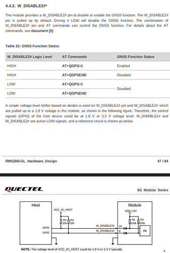

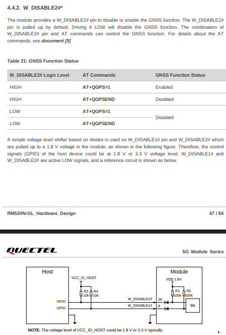

Could you also guide me on W_DISALEB2 Pin functionality Status !?
As it Hardware Design guide, it’s mentioned that it is under development (W_DISABLE #*), so can we assume that by default GNSS functionality is running, and not required to give pull up from source and attach pin to GPIO in host.
Dear @avi951
You can use AT command to enable or disable GNSS.
GNSS function is disabled by default.

Dear @Phuc_Tr_ng
It seems there have some hardware issue with your module, it is better to contact with your supplier.
