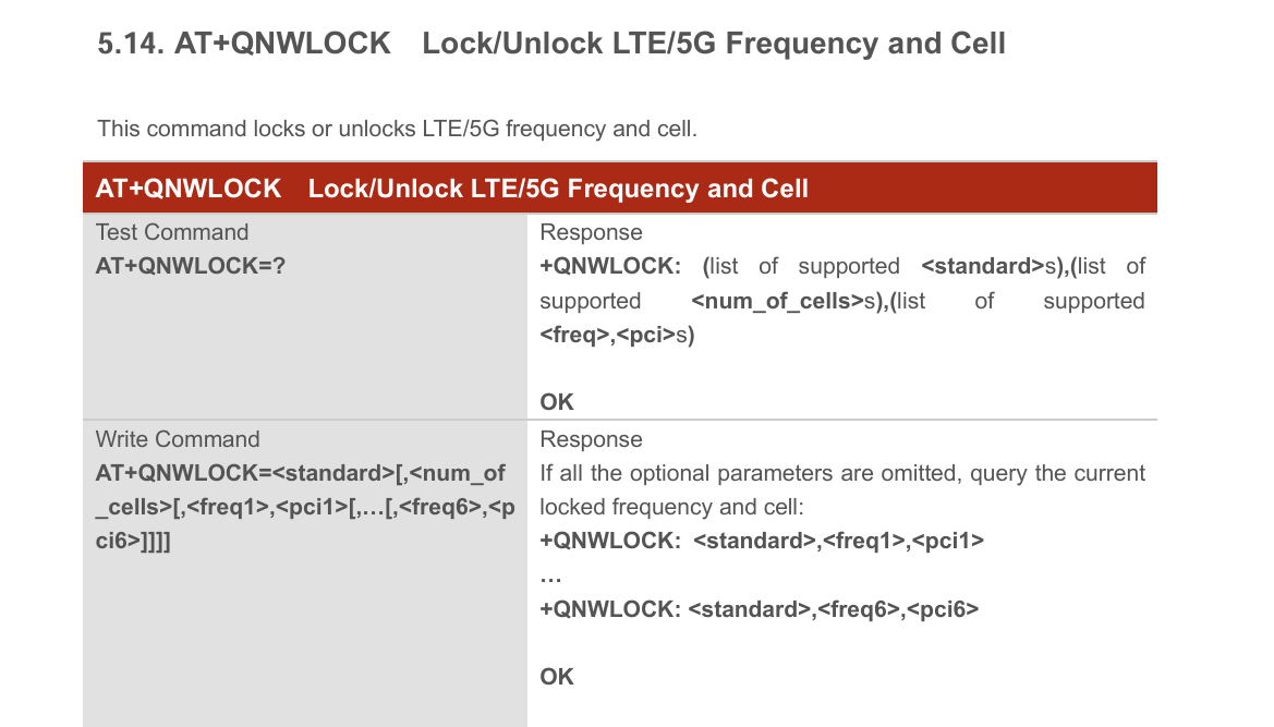

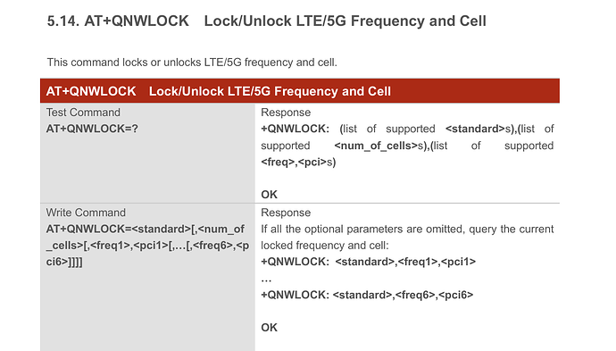

How can i get RM500U-CNV at commands list?
Also i have a question, Is it possible to lock the module to the specific arfcn/earfcn/uarfcn?
Thank you

Dear @kutay
I have sent AT command document to you via Message, please check.
