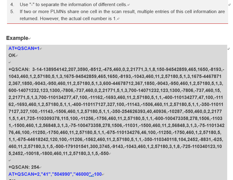

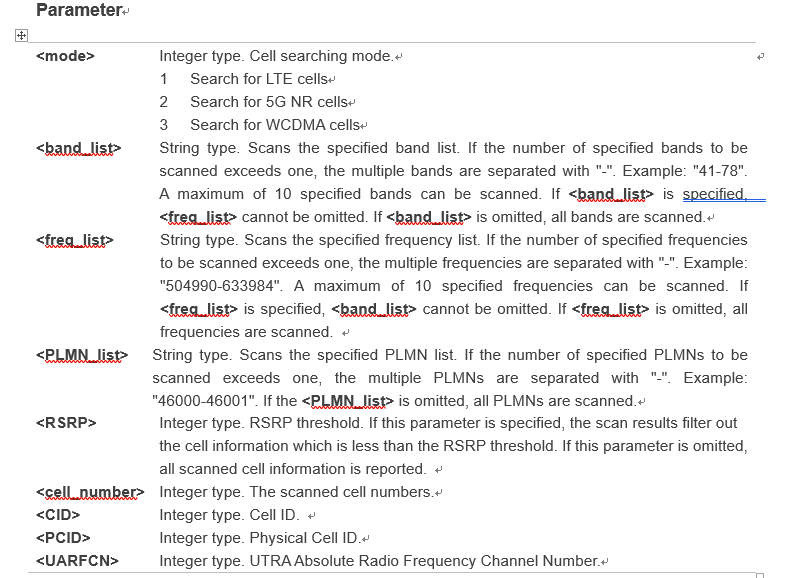

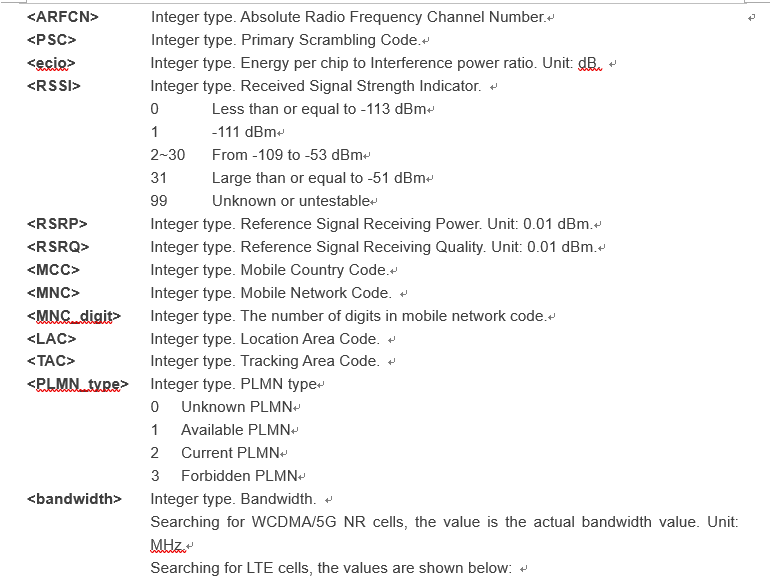

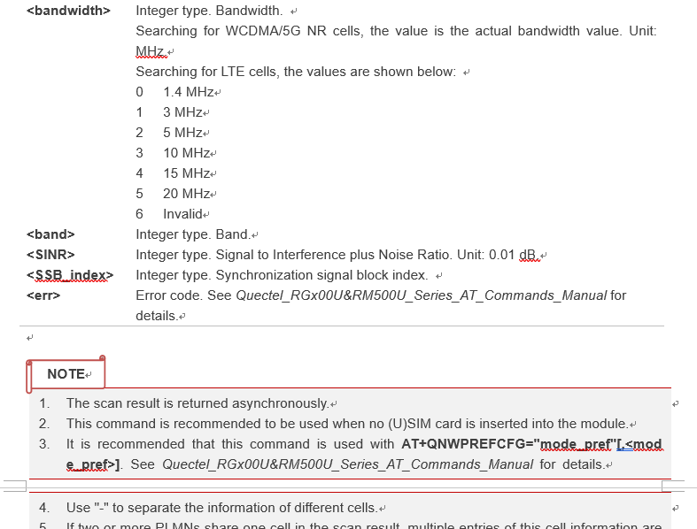

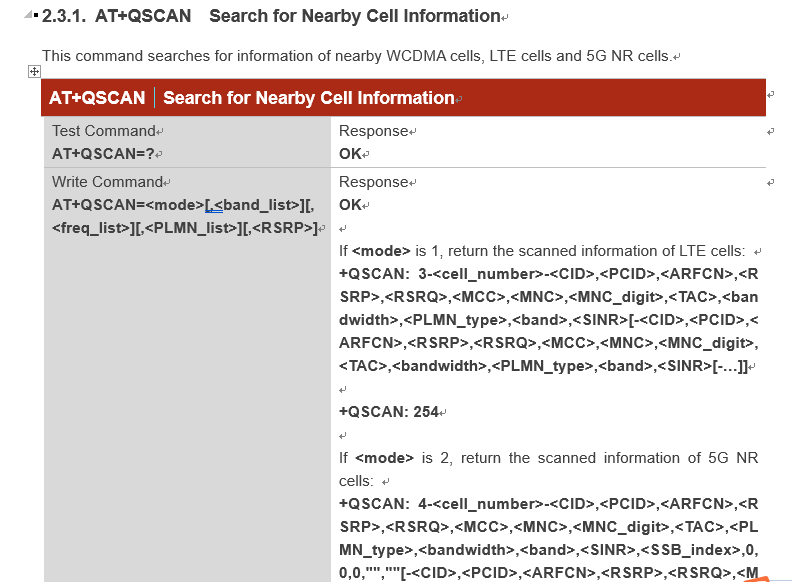

This functionality AT+QSCAN does work without a SIM. By the way, could you share the documentation for the AT+QSCAN format?
