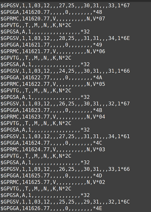

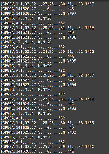

I am still not getting any NMEA logs. Here is my sequence of commands to start the GPS:
at+qgpscfg="outport","usbnmea"
OK
at+qgps=1
OK

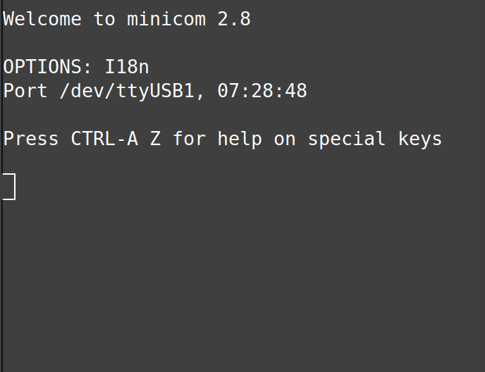

ttyUSB1 remains empty for a very long time:
