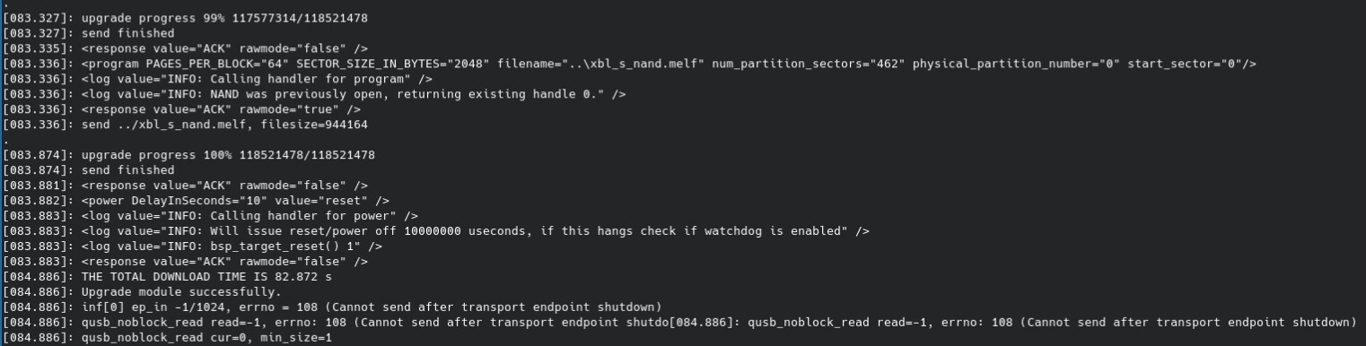

The upgrade process was completed and showed:
“Upgrade module successfully.”

The firmware upgrade log indicates that the process completed successfully at 100% before the reset command was issued.
