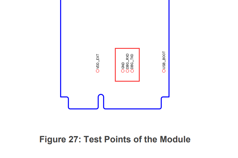

Dear @brainy
Is it possible to capture dmesg log from debug port?
@silvia
i dont think i can do that :frowning:
