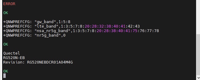

The device suddenly can’t use 5G, use :AT+QNWPREFCFG=“ue_capability_band” to query bands, and found that RG520N-EB doesn’t have sa band anymore

Do you try to use At command to comfirgure SA band?AT+QNWPREFCFG=“nr5g_band”

I tried AT+QNWPREFCFG=“nr5g_band” and AT+QNWPREFCFG=“nr5g_disable_mode”,0! read sa band still 0!
