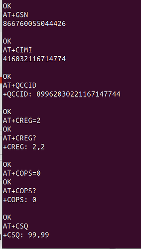

Your current signal quality is too poor. Please check if the antenna is working properly or if the SIM card is overdue.

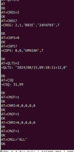

Please try receiving SMSs after using the AT+CNMI=0,0,0,0,0 setting.
I tried this command,
but it didn’t work for me. I also tried using another SIM card, but got the same result. The SIM card is fine; I tested it on my phone
Hi @mohand_zaatreh
Please show me the AT operation steps for sending text messages or making phone calls

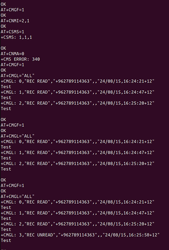

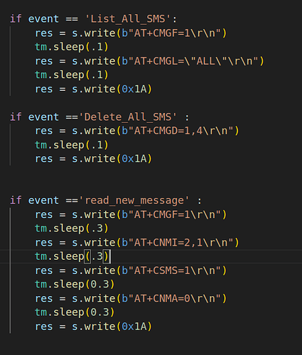

i use this steps
AT+CMGF=1
AT+CNMI=2,1
AT+CSMS=1
AT+CNMA=0
0x1A
i read all messges
AT+CMGF=1
AT+CMGL=\"ALL\"\r\n

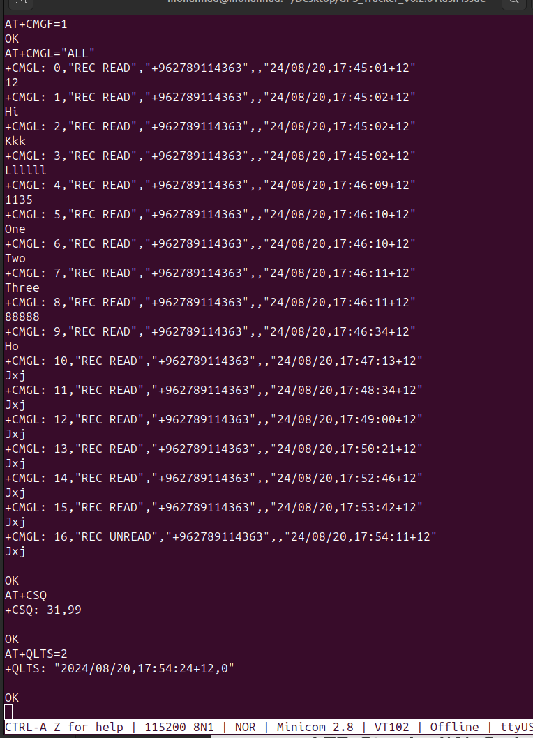

I’m having trouble receiving messages consistently, and there’s some strange behavior happening. I keep receiving a message that says ‘test,’ even when I send something different. For example, if I send ‘Hello world,’ the module still shows a new message as ‘test.’
I have sent some messages that said ‘test’ in the past, but not all of them. It seems like the module is stuck on ‘test’ and not displaying the correct messages.

A couple of comments on your code:
  1. Sending “\r\n” after an AT command is incorrect syntax. The “\n” shouldn’t be there.
There is only a single AT command termination character, which by default is “\r” (char 13) as defined in the modem’s S3 register:
ATS3?
013
OK
  1. Sending 0x1A is required only after entering a character string when input at the “>” prompt. It is not required with AT commands in general. Very, very few commands need it, and using it indiscriminately could have unpredictable consequencs.

You’ve got one SMS in “ME” stoarge. You should be able to read it with:
AT+CMGF=0;+CMGL=4          (PDU mode), or
AT+CMGF=1;+CMGL="ALL"      (text mode)

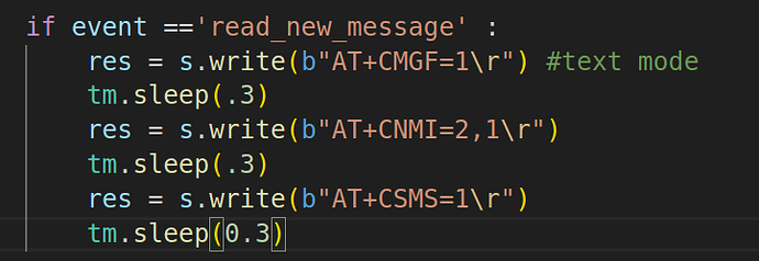

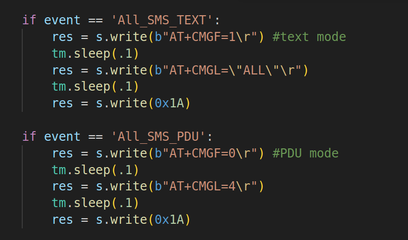

I can read messages directly without sending any command before th
if event == 'List_All_SMS':
        res = s.write(b"AT+CMGF=1\r")
        tm.sleep(.1)
        res = s.write(b"AT+CMGL=\"ALL\"\r")
        tm.sleep(.1)
        res = s.write(0x1A)```

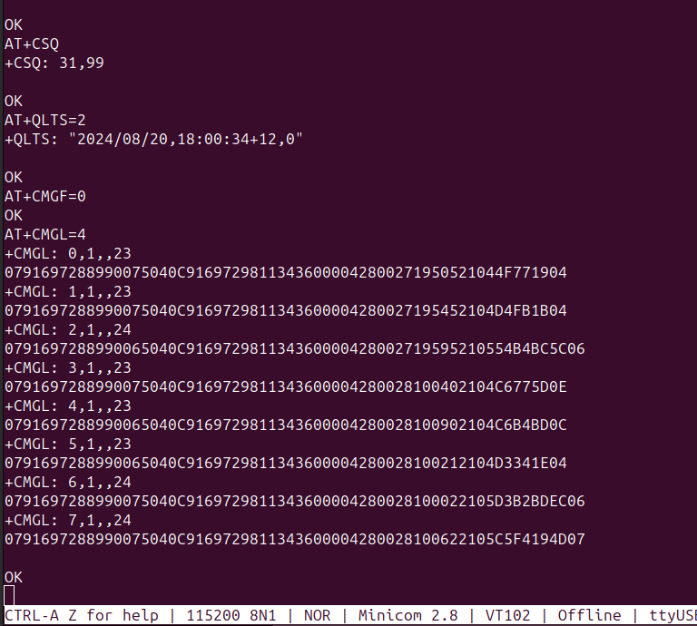

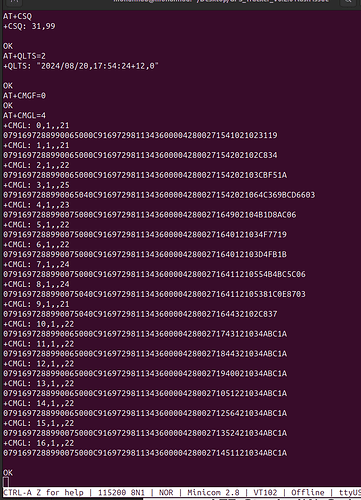

I’m experiencing the same problem again where the module gets stuck on the message ‘Jxj.’ Even though I send different messages, it always displays ‘Jxj’ instead.
This issue doesn’t occur all the time; it tends to happen after multiple power cycles of the module. Sometimes it works correctly, as shown in the attached images.

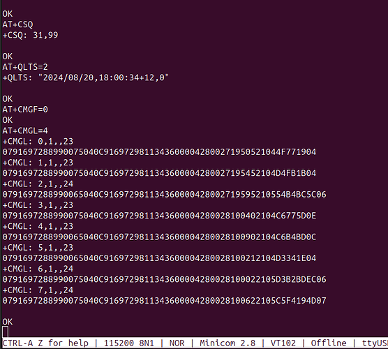

These two images show the same messages. The first one is in text mode, and the second one is in PDU mode.
text mode
PDU mode
After turning off and then turning on the power, the module starts working properly and reads all the messages I sent correctly, as shown in the images.
text mode
PDU mode

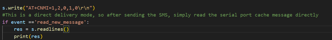

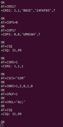

However, I am still facing issues with the SMS Event Reporting Configuration and New Message Acknowledgement to UE/TE.
I use these commands
Please show results of AT commands as text, and not graphics. I need to retype your PDUs when I want to analyze them.
There’s clearly a bug in your modem’s firmware which runs deep. It affects PDU-mode as well as text-mode.
I believe you need to upgrade your firmware. On one firmware version, my EM12-G had a bug where the SMS PDU list was corrupted (I always use PDU-mode).
It’s possible the same bug has affected certain firmware across different Quectel models.

AT+CMGF=0
OK
AT+CMGL=4
+CMGL: 0,1,,23
0791697288990075040C91697298113436000042800271950521044F771904
+CMGL: 1,1,,23
0791697288990075040C9169729811343600004280027195452104D4FB1B04
+CMGL: 2,1,,24
0791697288990065040C916972981134360000428002719595210554B4BC5C06
+CMGL: 3,1,,23
0791697288990075040C9169729811343600004280028100402104C6775D0E
+CMGL: 4,1,,23
0791697288990065040C9169729811343600004280028100902104C6B4BD0C
+CMGL: 5,1,,23
0791697288990065040C9169729811343600004280028100212104D3341E04
+CMGL: 6,1,,24
0791697288990075040C9169729811343600004280028100022105D3B2BDEC06
+CMGL: 7,1,,24
0791697288990075040C9169729811343600004280028100622105C5F4194D07
OK

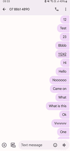

here it’s stuck on message “Hi”
OK
AT+CMGF=1
OK
AT+CMGL="ALL"
+CMGL: 0,"REC READ","+962789114363",,"24/08/21,09:28:04+12"
12
+CMGL: 1,"REC READ","+962789114363",,"24/08/21,09:28:12+12"
Test
+CMGL: 2,"REC READ","+962789114363",,"24/08/21,09:28:19+12"
23
+CMGL: 3,"REC READ","+962789114363",,"24/08/21,09:28:26+12"
Bbbb
+CMGL: 4,"REC READ","+962789114363",,"24/08/21,09:28:35+12"
11242
+CMGL: 5,"REC READ","+962789114363",,"24/08/21,09:28:46+12"
Hi
+CMGL: 6,"REC READ","+962789114363",,"24/08/21,09:29:20+12"
Hi
+CMGL: 7,"REC READ","+962789114363",,"24/08/21,09:29:41+12"
Hi
+CMGL: 8,"REC READ","+962789114363",,"24/08/21,09:30:13+12"
Hi
+CMGL: 9,"REC READ","+962789114363",,"24/08/21,09:30:43+12"
Hi
+CMGL: 10,"REC READ","+962789114363",,"24/08/21,09:31:05+12"
Hi
+CMGL: 11,"REC READ","+962789114363",,"24/08/21,09:32:25+12"
Hi
OK
AT+CMGF=0
OK
AT+CMGL=4
+CMGL: 0,1,,21
0791697288990065040C91697298113436000042801290824021023119
+CMGL: 1,1,,23
0791697288990075040C9169729811343600004280129082212104D4F29C0E
+CMGL: 2,1,,21
0791697288990075040C9169729811343600004280129082912102B219
+CMGL: 3,1,,23
0791697288990075040C916972981134360000428012908262210442B1580C
+CMGL: 4,1,,24
0791697288990065040C9169729811343600004280129082532105B1988C2603
+CMGL: 5,1,,21
0791697288990075040C9169729811343600004280129082642102C834
+CMGL: 6,1,,21
0791697288990075000C9169729811343600004280129092022102C834
+CMGL: 7,1,,21
0791697288990065000C9169729811343600004280129092142102C834
+CMGL: 8,1,,21
0791697288990075000C9169729811343600004280129003312102C834
+CMGL: 9,1,,21
0791697288990065000C9169729811343600004280129003342102C834
+CMGL: 10,1,,21
0791697288990065000C9169729811343600004280129013502102C834
+CMGL: 11,1,,21
0791697288990075000C9169729811343600004280129023522102C834
OK
these is the messages that I send when the module stuck on “Hi” not all message received or read from module
I realised the issue happened after I send this command depending on my test

Which command? The last of the three (AT+CSMS=1)?
If so, try leaving it as zero. Does something not work as required if you do that?
thanks it’s solve the issue and it’s no more stuck on the same message
