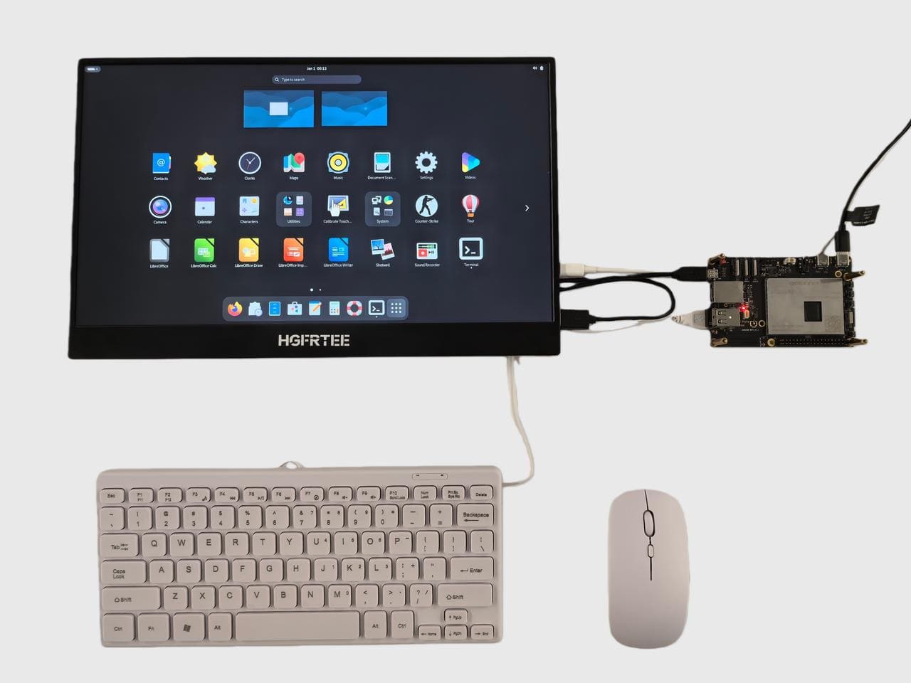

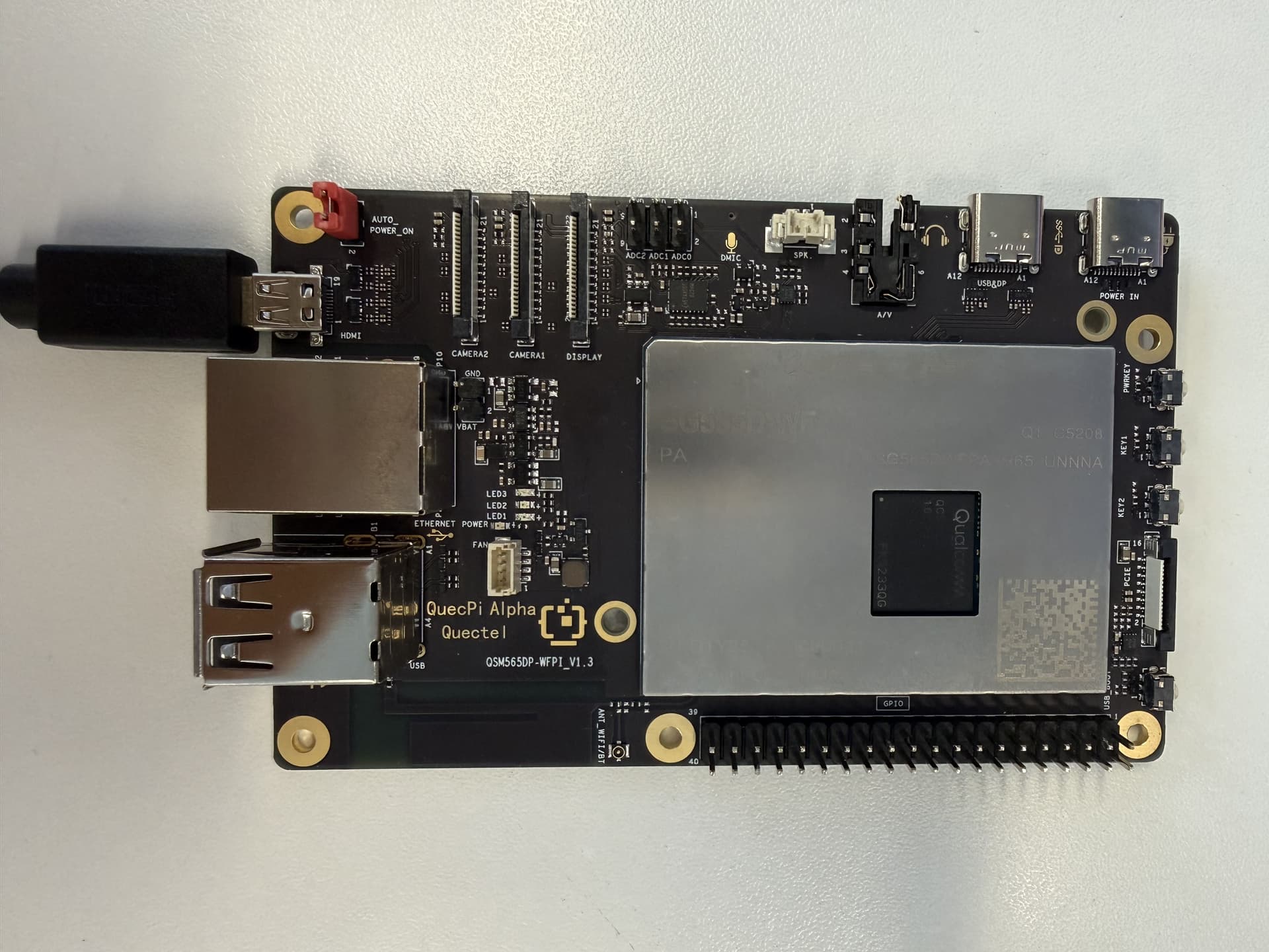

- Display Connection :
- Option 1 (High Definition): Connect one end of the USB-C DP display cable to the USB&DP interface of the single-board computer, and the other end to the USB-C interface of the monitor;
- Option 2 (Compatibility): Connect one end of the HDMI cable to the HDMI interface of the single-board computer, and the other end to the HDMI interface of the monitor.

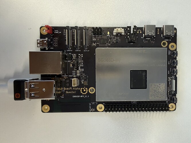

- Peripheral Connection : Connect the USB keyboard and mouse to the two USB-A interfaces of the single-board computer; for wireless keyboard and mouse, insert the receiver into the USB port.

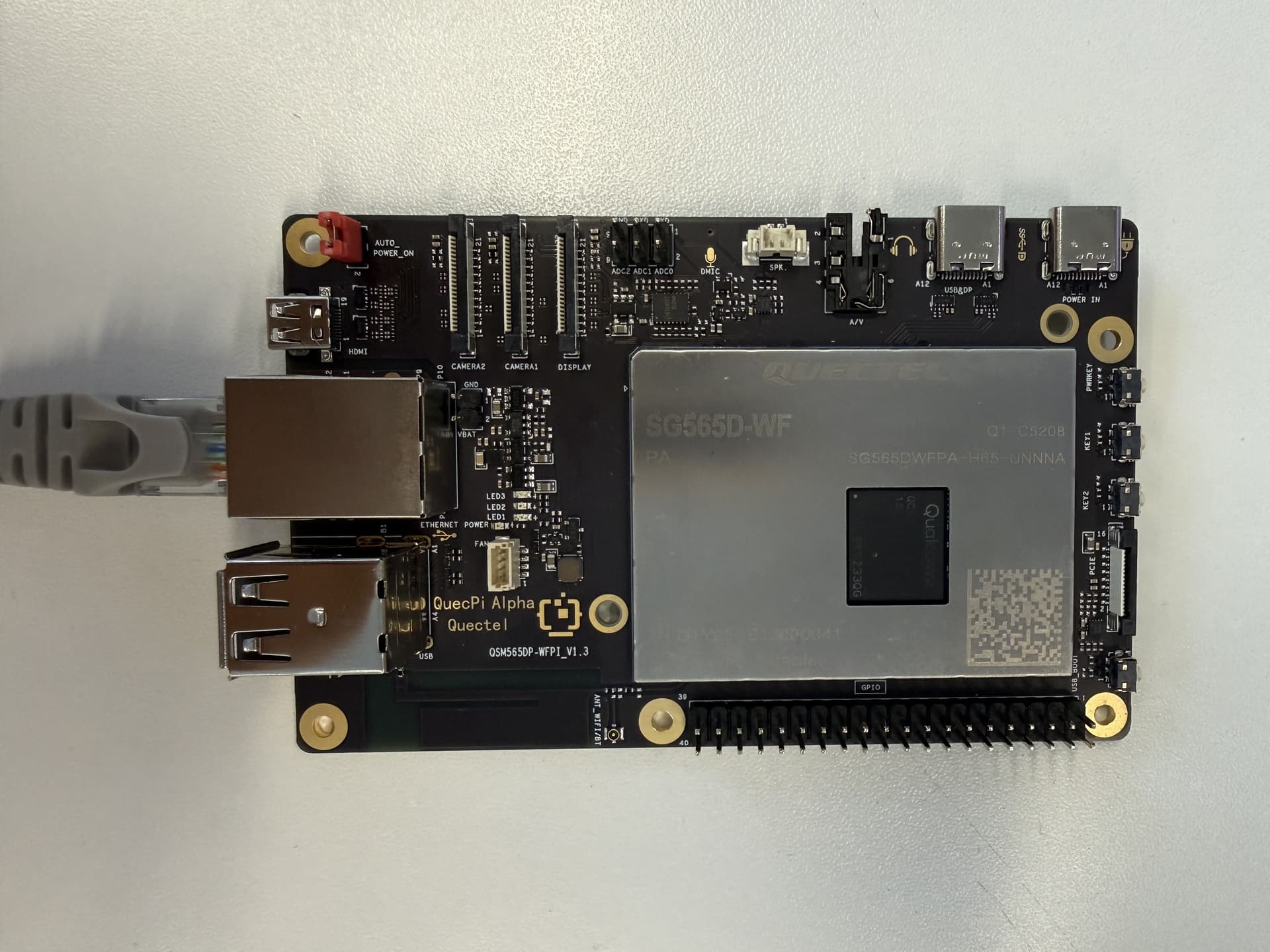

- Network Connection : Connect the network port of the single-board computer to the LAN port of the router using a network cable.

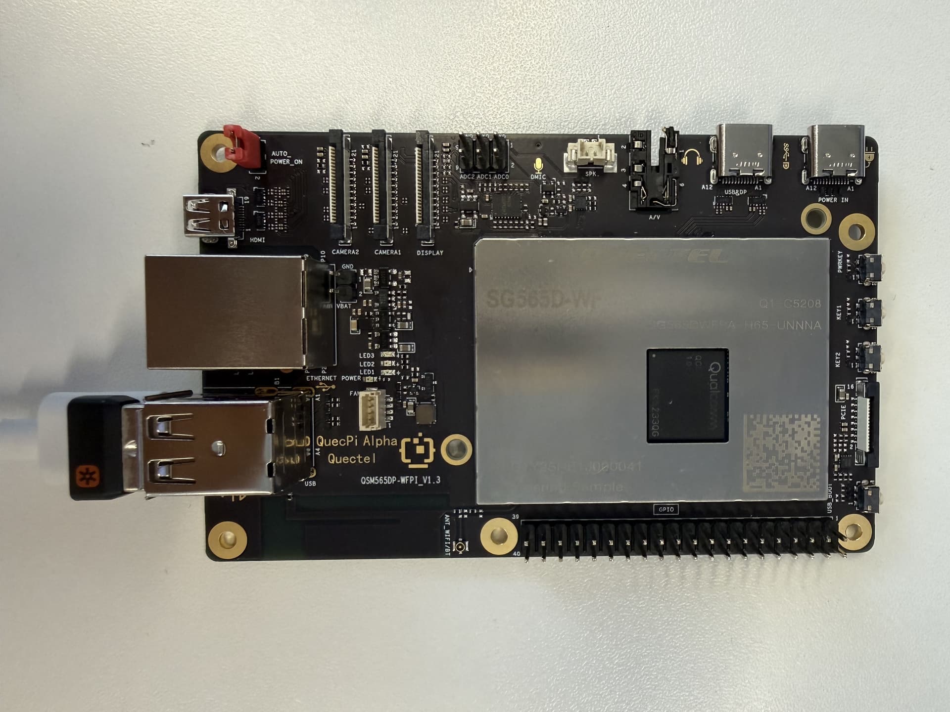

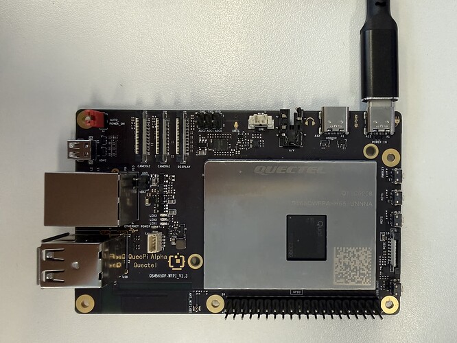

- Jumper Cap Connection : Ensure that the pin header marked with
AUTO_POWER_ONin the upper left corner of the single-board computer is shorted with a jumper cap.
- Power Supply Connection : Finally, connect the USB-A end of the USB-A power cable to the power adapter, and the USB-C end to the power port of the single-board computer (usually marked
POWER IN).

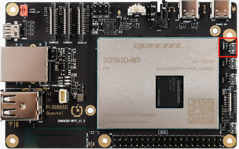

If the pin header marked AUTO_POWER_ON was not shorted with a jumper cap during the previous hardware connection, you need to first long-press the PWRKEY button on the right side of the single-board computer, then turn on the power until the system starts.
- Turn on the monitor power and confirm that the monitor input source has been switched to the corresponding interface (such as USB-C or HDMI).
- Turn on the power of the single-board computer (plug in the power cable). At this time, the power indicator (usually red) of the single-board computer will be on steadily, and the system indicator (usually green) will flash, indicating that the system is starting.
- Wait for about 1-2 minutes, and the monitor will display the system login interface.
