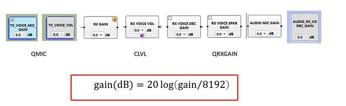

Hi,@udossantos
For your reference. I hope it will be helpful to you.
Below is a picture shows what we could control with the QMIC &CLVL & QRXGAIN , and the conversion relationship with dB
And when setting the AT+QAUDMOD=3 and CLVL=5, the gain of QMIC and QRXFAIN, it would be 0db by default, you do not need to setting them again.
