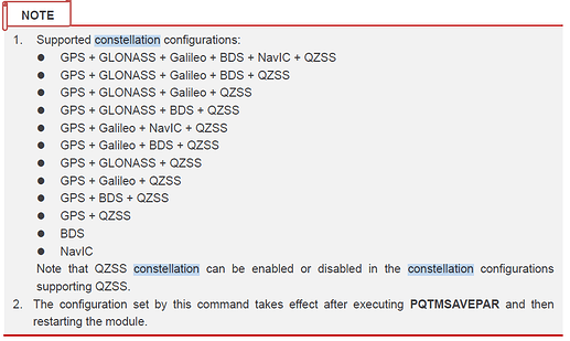

For constellation configuration, you can send below command to enable it. This should be applicable to current firmware as well.
$PQTMCFGCNST,W,<GPS>,<GLONASS>,<Galileo>,<BDS>,<QZSS>,<NavIC>*<Checksum><CR><LF>
Example: To enable Beidou and GLONASS and others
$PQTMCFGCNST,W,1,1,1,1,1,1*2B //This is to enable all GNSS constellation.
For more information, please refer to this GNSS protocol: Quectel_L89(HA)_GNSS_Protocol_Specification_V1.1 | Quectel
