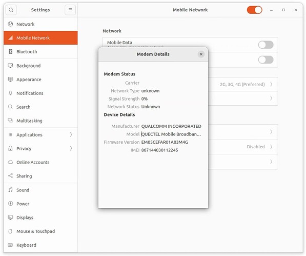

I am using a Quectel EM05CEF modem on Ubuntu 22.04. The modem is detected as /dev/cdc-wdm1 and wwan0, and the SIM card is present and ready. However, it cannot register on the network and no data connection is established.

From your screenshot and the behavior, you described, Ubuntu is detecting the EM05CEF correctly as a QMI/WWAN modem (/dev/cdc-wdm1 and wwan0). However, the modem is not registering because it is not camping on any cell (the GUI also shows Signal 0% and Network status/type: Unknown).
This is typically caused by RF/antenna issues, weak/no coverage, or the module being locked/misconfigured to unsupported RAT/bands, not a ModemManager compatibility problem.
