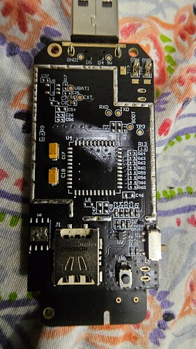

here’s a picture of my device in case anyone is wondering

Anyone? it is kinda urgent as I am travelling and will use this for internet.
Please see
@icee
T: Bus=07 Lev=03 Prnt=03 Port=03 Cnt=01 Dev#= 4 Spd=480 MxCh= 0
D: Ver= 2.00 Cls=ef(misc ) Sub=02 Prot=01 MxPS=64 #Cfgs= 2
P: Vendor=2c7c ProdID=0125 Rev= 3.18
S: Manufacturer=Quectel
S: Product=EG25-G
C:* #Ifs= 2 Cfg#= 1 Atr=a0 MxPwr=500mA
A: FirstIf#= 0 IfCount= 2 Cls=e0(wlcon) Sub=01 Prot=03
I:* If#= 0 Alt= 0 #EPs= 1 Cls=e0(wlcon) Sub=01 Prot=03 Driver=rndis_host
E: Ad=82(I) Atr=03(Int.) MxPS= 8 Ivl=32ms
I:* If#= 1 Alt= 0 #EPs= 2 Cls=0a(data ) Sub=00 Prot=00 Driver=rndis_host
E: Ad=81(I) Atr=02(Bulk) MxPS= 512 Ivl=0ms
E: Ad=01(O) Atr=02(Bulk) MxPS= 512 Ivl=0ms
C: #Ifs= 2 Cfg#= 2 Atr=a0 MxPwr=500mA
A: FirstIf#= 0 IfCount= 2 Cls=02(comm.) Sub=06 Prot=00
I: If#= 0 Alt= 0 #EPs= 1 Cls=02(comm.) Sub=06 Prot=00 Driver=
E: Ad=82(I) Atr=03(Int.) MxPS= 16 Ivl=32ms
I: If#= 1 Alt= 0 #EPs= 0 Cls=0a(data ) Sub=00 Prot=00 Driver=
I: If#= 1 Alt= 1 #EPs= 2 Cls=0a(data ) Sub=00 Prot=00 Driver=
It seems customized firmware and should not be RNDIS mode.
Please set the modem to RMNET or MBIM mode.
You can it in this way.
sudo modprobe -r option
sudo modprobe option
echo 2C7C 0125 FF | sudo tee  /sys/bus/usb-serial/drivers/option1/new_id
And then you should be able to see the ttyUSB for AT.
