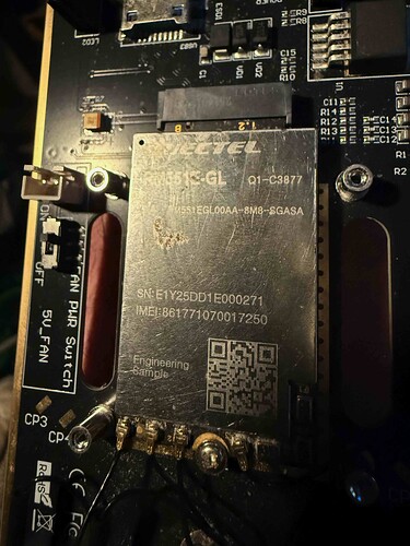

I have a Quectel 551e-GL module m the module appears to be bricked: it now shows up in QDLoader 9008 mode in the Windows Device Manager, and the usual USB port for programming is no longer available.
Unfortunately, I do not have any firmware files to attempt a recovery, and I haven’t found a clear procedure to unbrick the module from this state.

Dear @John_Brady
What operation did you perform that caused this issue?
Please take a picture of shield cover.
I was updating the firmware.
