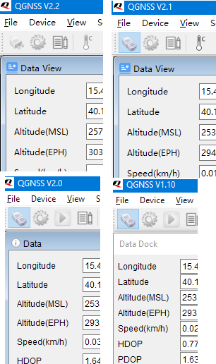

Using QGNSS V2.2, I have a QLM290P set as a base station.
I have configured it’s fixed co-ordinates, but it shows the Altitude(EPH) as MSL.
This is the co-ordinate data:
|Latitude|S33° 53’ 53.2518"|± 0.021 m (95%)|
|Longitude|E18° 33’ 27.2490"|± 0.023 m (95%)|
|Ellipsoidal Height|68.642 m|± 0.065 m (95%)|
The commands used:
$PQTMCFGRCVRMODE,W,2
$PQTMCFGSVIN,W,2,0,0,5024068.446,1686644.865,-3537111.051
$PQTMSAVEPAR
The result in the dataview window, shows altitude as MSL and nothing in EPH.
What am I doing wrong?
TIA
Input are correct…
Thanks bamarcant,
So does this mean it’s a bug in QGNSS V2.2 showing Altitude(MSL) as 68.64 instead of Altitude(EPH)?
Describe the settings…
with GGA sentence here the outputs
Yea it is a bug , setting in fix mode gives incorrect position.
