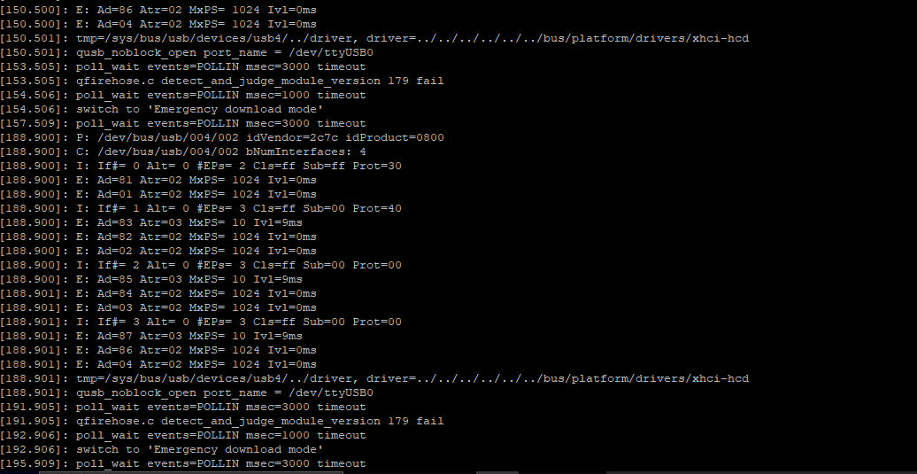

i have tried use qfire update module but it is showing failed see belowf ,any advise to fix it
Could you show the complete QFirehose log and the dmesg log?
It is a virtual machine?
Is the USB 2.0 DP/DM connected?
Just from this log, it seems that the Modem did not enter the EDL mode or the Linux did not detect the modem.
