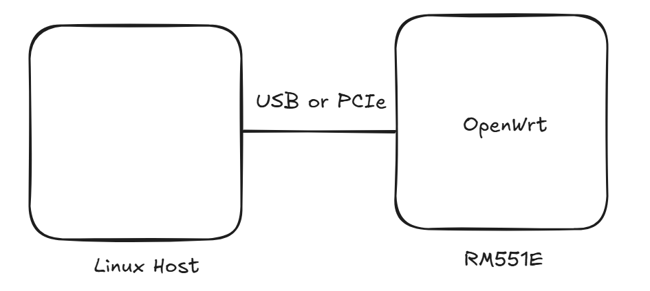

The module you get is a standard cellular module. Although it runs OpenWrt, it is not a development board. You can only use it as a modem and connect it to a Linux Host SoC.
If you must develop a router based on RM551E, please contact the salesperson and develop based on RG651E. Quectel will release the SDK for RG651E.
