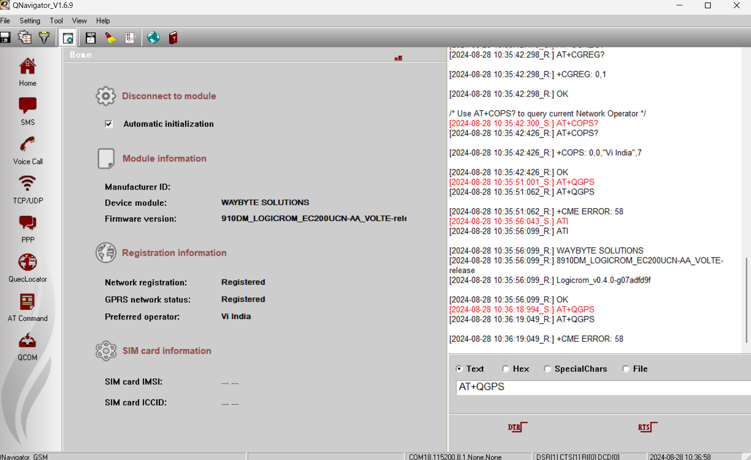

Not able to Access "AT+QPS" on EC200U-CN
board info:
R:] ATI
R:] WAYBYTE SOLUTIONS
R:] 8910DM_LOGICROM_EC200UCN-AA_VOLTE-release
R:] Logicrom_v0.4.0-g07adfd9f
Hi @prajyot_nimje

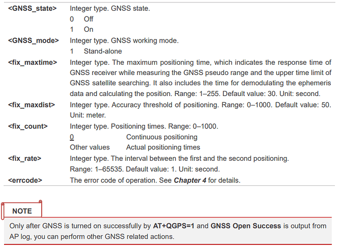

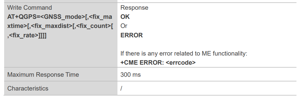

“AT+QGPS” needs to be used with parameters, such as “AT+QGPS=1”

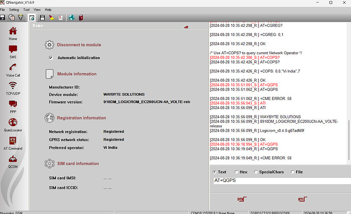

i have used that also..
[2024-08-28 11:27:42:456_S:] AT+QGPS=1
[2024-08-28 11:27:42:512_R:] AT+QGPS=1
[2024-08-28 11:27:42:512_R:] +CME ERROR: 58
this is the response
i have also reset the module using “AT&F” command , then also it shows same error…is this problem of firmware or something else??
Please check:
1)Is the antenna is functioning properly?
2)Is the signal normal?
3)Try it outdoors
yes all done .. i have put antenna outdoor.
