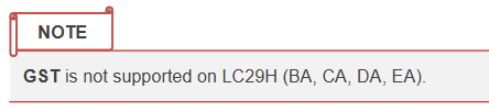

Hi @thn80
Hello, the LC29HDA module does not support GST messages. There is no development plan at present.

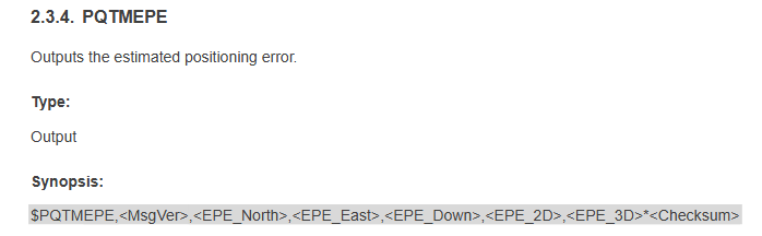

Is there any other NMEA message on the LC29H (DA) that outputs the accuracy of the current position?
There is not much need of a GNSS RTK module if there is no information available on the accuracy of the position.
Thanks,
Thomas
Similar is $PQTMCFGMSGRATE,W,PQTMEPE,1,2*1D
