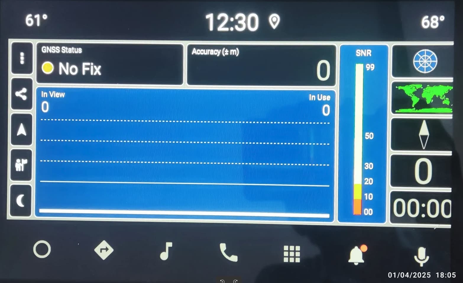

Hi @Bean.Wang-Q
I successfully installed the GPS test 1.5.3 version of apk to test whether the GPS is working or not, but I wasn’t able to see any location status in this app. I will provide the log of
logcat -s gps_ql -v time
logcat -s gps_ql -v time.txt (16.3 KB)
The GPS didn’t turn on.
You should send the AT command
AT+QGPS=1 before you start the GPS APK.
To which port do I need to send the command, ttyUSB0 or ttyUSB1?. I can see only two ports available in the dev partition.
There should be 4 ttyUSB. If there is only two ttyUSB it means that the Linux kernel dirver is not correct.
