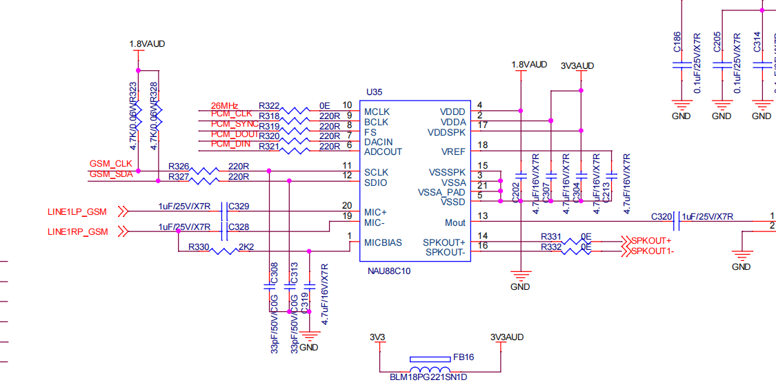

I have an image of the EC200 connected to an audio codec, but since I2C is not supported, how can I configure Q-Navigator to work with another audio codec like the NAU88C10?
The module do have an I2C interface. What firmware version do you have?
yes,pin 11,12 are I2C.
