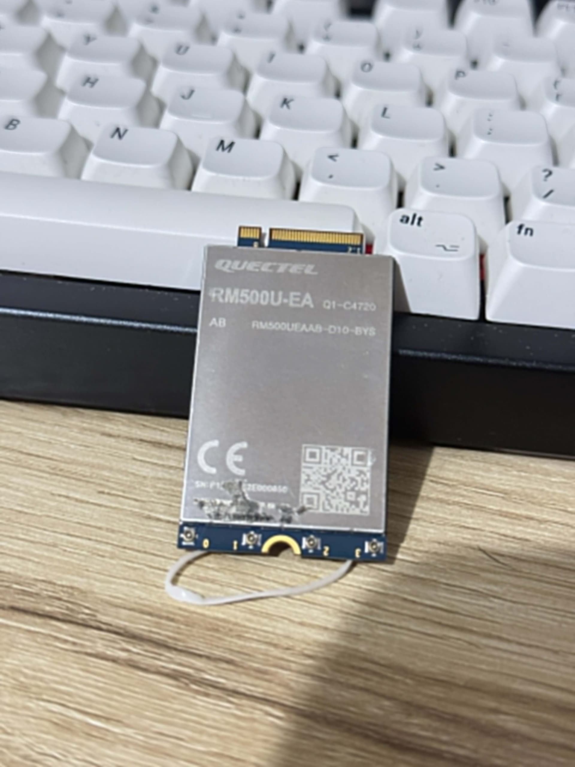

Please provide the version of your current firmware.
ATI
@herbert.pan-Q can you send latest firmware RM500UEAAAR03A11M2G
I have sent it to your email,pls check
