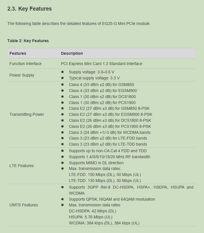

Is this due to a power supply or firmware issue? The current firmware installed on my Pi is: EG25GGBR07A08M2G_30.200.30.200. The Pi firmware is: 6fe0b091 (release). Thanks!
Hi @ElectricAnt
It seems to be related to the power supply. Please check whether the power supply voltage is 3.3v?
