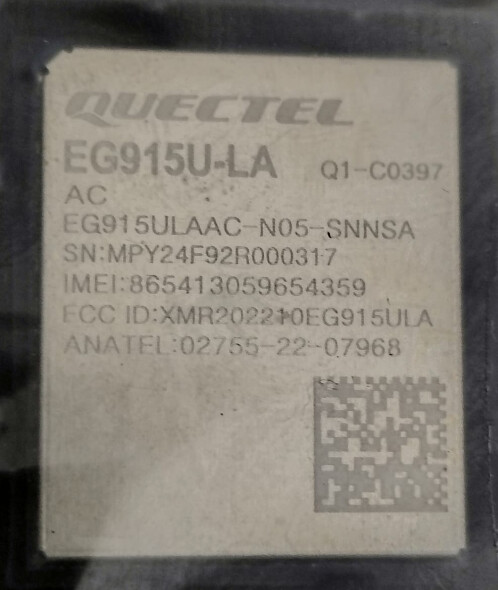

Looking for the latest firmware for EG915U-LA
Hello !
i’m looking for the latest firmware for EG915U-LA but i can’t find where i can download it
