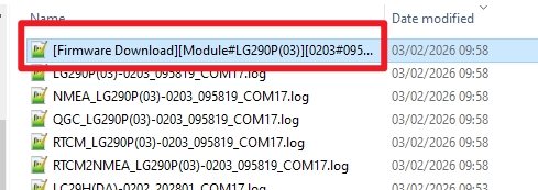

Can you send me the log file regarding the firmware upgrade from the QGNSS?
you can send me through email
yong.huang@quectel.com
I’ll send it to you right away. As for the PC, I’ll try to find one. Just one more detail: I wanted to install firmware version LG290P03AAN02A01.
