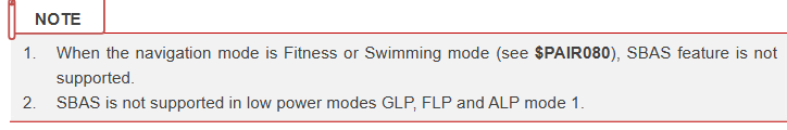

Module support SBAS (including WAAS, EGNOS, GAGAN, and MSAS) and
SLAS if under Qzss L1S signal in latest firmware…ask @Jasper for fw.
But be aware of previous 1.4 manual:
for enable SLAS see 2.3.27 ; 2.4.37

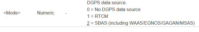

$PAIR400,3*21
$PQTMCFGSLAS,W,1*31
latest 1.5 manual here https://www.quectel.com/content/uploads/2024/04/Quectel_LC26GLC26G-TLC76GLC86G_Series_GNSS_Protocol_Specification_V1.5.pdf

in gnss manual the 1 i.e $PAIR400,1*23 is the command but as sayd do not work…
