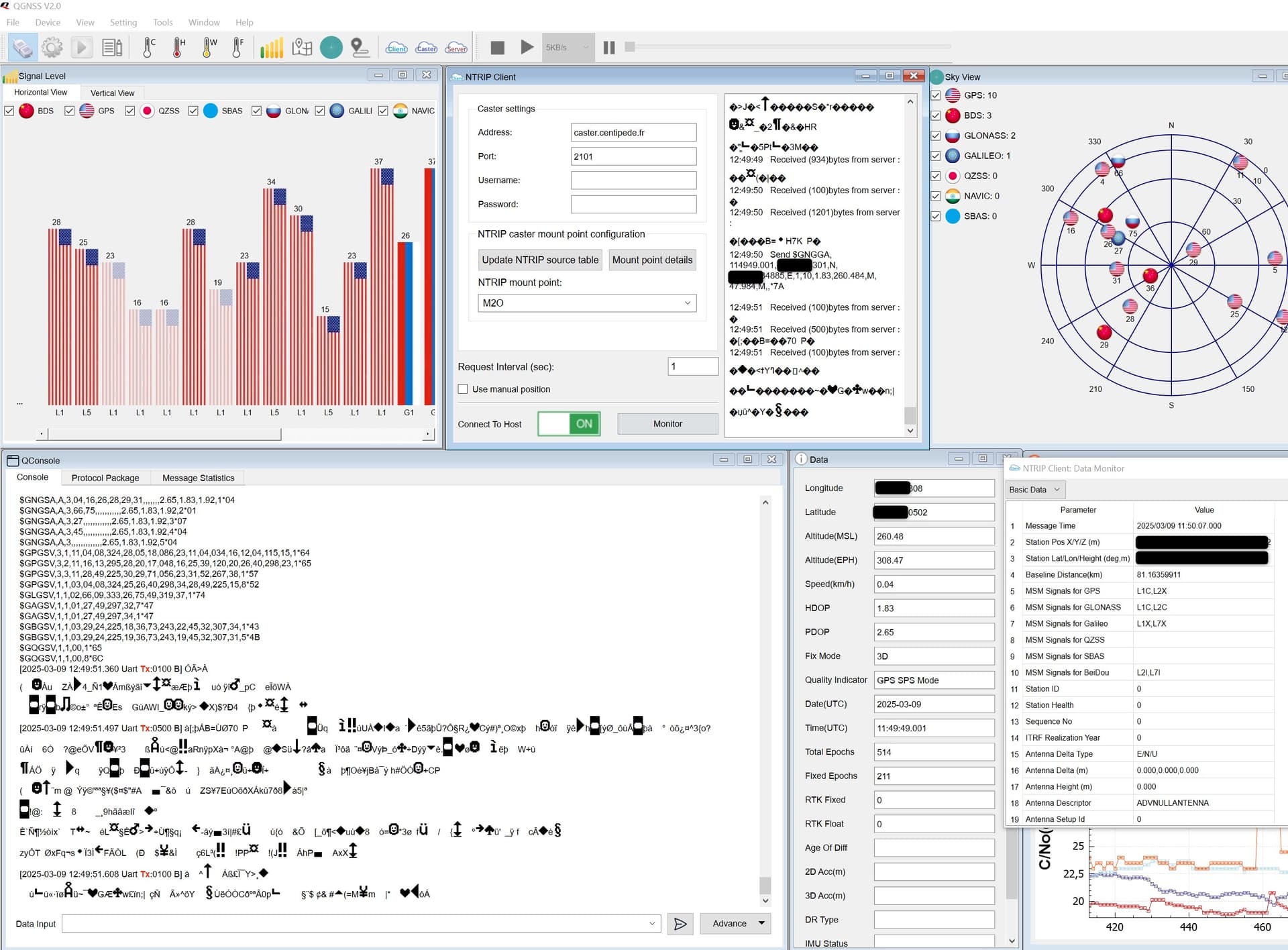

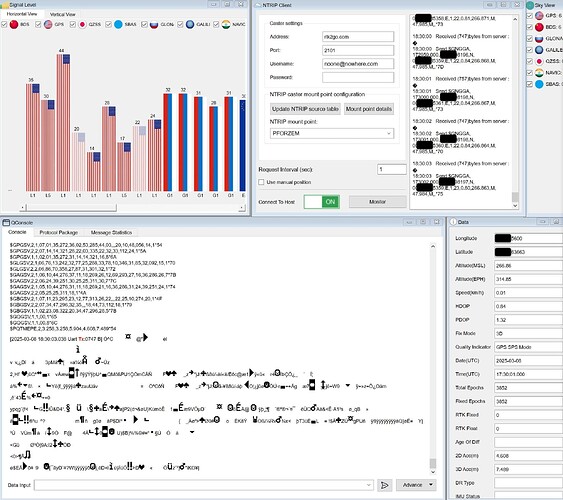

I want my LC29H (DA) to act as a rover and to get the NTRIP corrections via RTK2go.com.
In QGNSS I added the NTRIP client as shown in the screenshot attached. The connection to the server seems to work, but I don’t get an RTK Fix and the QConsole only shows some rubbish for the data send to the module.
Do you have any idea what’s going wrong?

Try other caster…
euref-ip.net or igs-ip.net upon registration: BKG Ntrip registration
or some near caster.centipede.fr 2101 (M2O m.point) free without user/pass
Still the same issue with another caster.
Need nearest caster max 30km and full outside rover side…in the open field.

try also full reset and redone rover setup…
