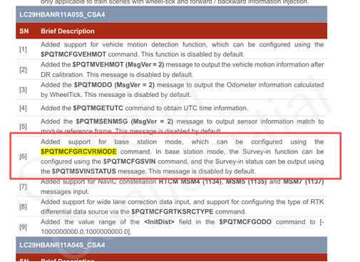

  1. Could this error be happening because my A02S firmware (from 2023) is simply too old and does not support the $PQTMCFGRCVRMODE command, even though the newer V1.5 protocol manual includes it for the (BA) variant?
  2. If my firmware is the problem, what is the correct procedure for an individual user to get the latest firmware file (.pkg or .bin) and the correct QGNSS tool to update this module?
Thank you for your help.
Hi Phúc Khang Nguyễn
I have try use this command $PQTMCFGRCVRMODE,W,1*2A in A02S, which is not success. Then use it in A06s, which works successfully.
Please try to upgrade firmare to solve this problem.
I have sent the latest firmware through email, please check it.
