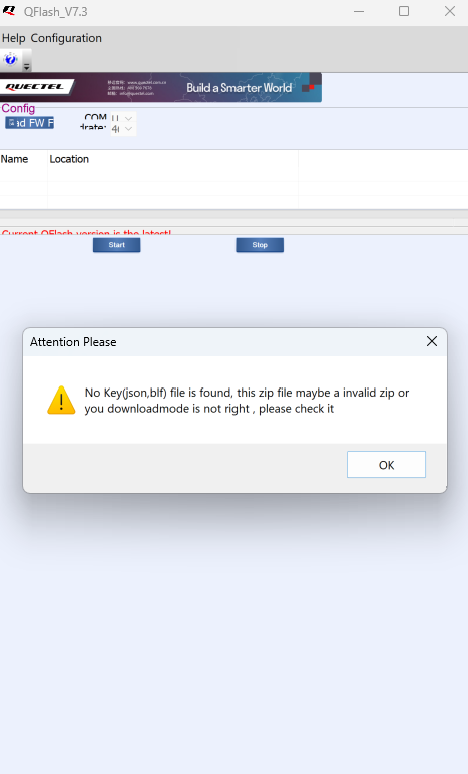

Hi, I am getting the following error when trying to upload the FW:
I also tried with Latest QFlash tool V7.3
Can you also clarify that it works with RM502 QA module ? Its not mentioned in user guide.
Dear @ankit
Please unzip the firmware package and select the corresponding file.
In QFlash package, there have user guide, please refer to it.
