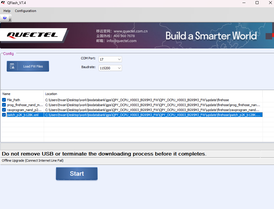

Hello,
I am currently using a BG95-M3 Zero module and attempted to flash new firmware using QFlash.
I used the following firmware package:
  • Firmware: QPY_OCPU_V0003_BG95M3_FW
  • Firehose file: prog_firehose_nand_mdm9x05.elf
QFlash shows a “PASS” message, which seems to indicate a successful flash. However, the firmware does not appear to change.
For example, when I run modem.run_cmd(“ATI”), I get the following output:
ERROR
Quectel
BG95-M3
Revision: BG95M3LAR02A03
ERROR
This looks like the QuecPy runtime is still present and the AT command interface is not working.
Could you please help me understand:
  1. Why is the firmware not being applied even after QFlash shows “PASS”?
  2. Is there an extra step required to properly activate the flashed firmware?
  3. Is it possible that the firmware package is missing something required to replace QuecPy?
Thank you for your support.
