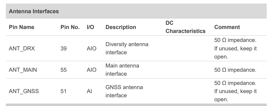

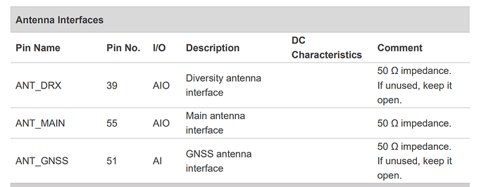

I have an RM520N-GL with four antenna connectors, but an application where it is possible to use only two antennas. Is it possible to use only two antennas, and if so, which antenna ports should be connected?
Jorgen Pihlflyckt
Dear @jorgen.pihlflyckt
For RG255C-GL, it has three antennas. If don’t use GNSS feature, you can contact 2 antennas.

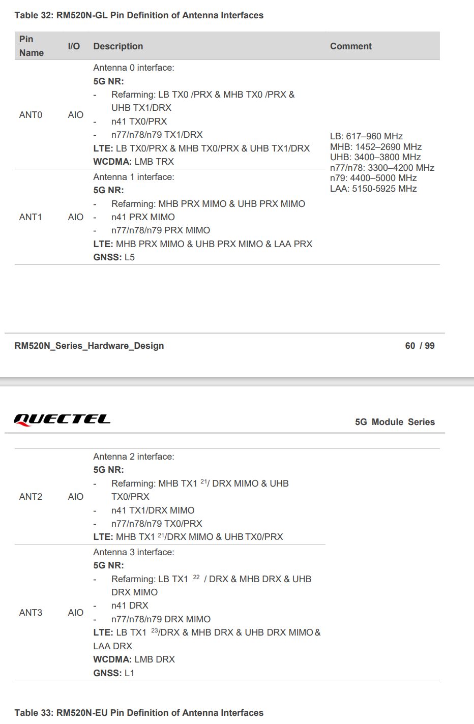

How about the RM520N-GL?
That modem has four (4) antenna connectors.
Jorgen Pihlflyckt
RM520N-GL has 4 antennas, here is the description about these. It seems if use 2 antannas, some performance will be worse or other problem.
