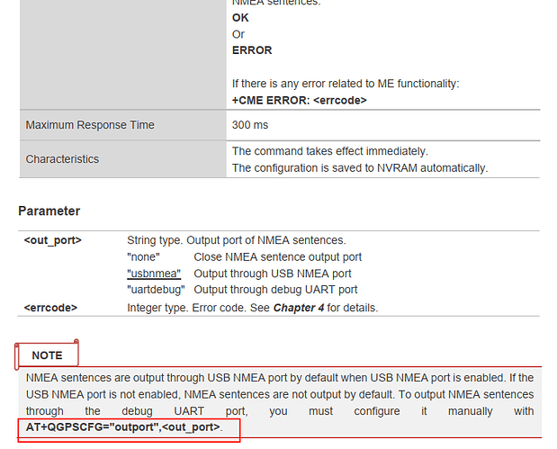

I am currently using the EG800K module for our project, and I would like to confirm whether this module supports a 1PPS (Pulse Per Second) signal output.
If it does, could you please provide details about the corresponding pin, electrical characteristics, and how to enable or configure it?
Thank you for your support, and I look forward to your reply.
Best regards,
Dai Ho
It is supported. You need to configure the corresponding GNSS statement output port.
Could you please confirm the exact physical pin number on the EG800K module where the 1PPS signal is output, and whether it is available on all variants (EG800K-CN, EG800K-EU, EG800K-LA) or only specific ones?
No physical pin, Support PPS output
