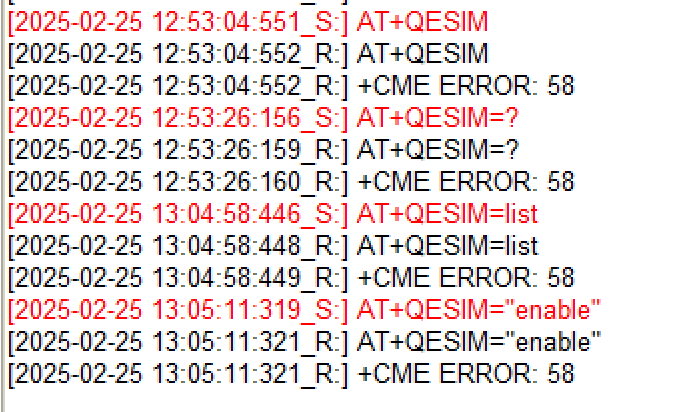

I am trying to use ESIM command for EC200U-CN
I get a CME+ 58 error. Is there any firmware file for this such that it supports it? or any manual?
ESIM we use is ST4SIM 400
Please refer to the attached image and help for the same.
Thank you
It indicates that it is not supported, and if you need eSIM functionality, you usually need to contact QUECTEL for customization
whom do i contact? Kindy let me know.
Please contact the channel where you got the module
