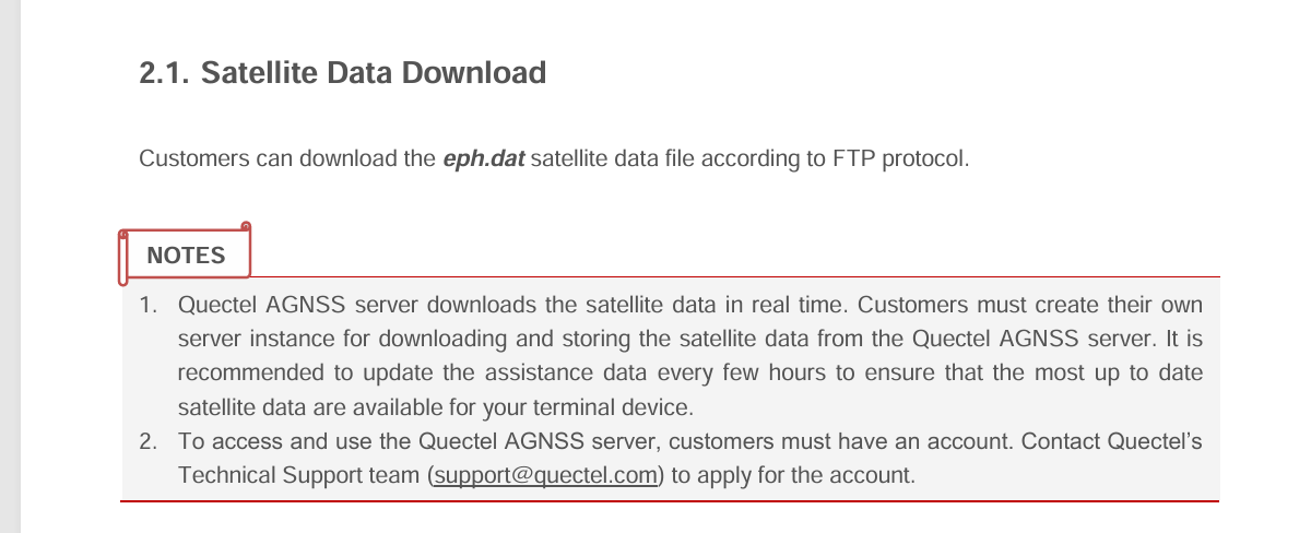

We’re using the L76KB module on our project and need access to EPO file from our firmware to enable quick TTFF. Looking at documentation, we need the VendorId, ProjectId & DeviceId to download the files from MediaTek’s servers and serve on our own servers. Where can we find this?

If customers want to use AGNSS of L76K, you need to apply for the account from us. Please provide information as follows:
  1. Module model
  2. Usage area
  3. Company name
  4. Estimated maximum number of connected devices?
  5. Whether there is its own server for access?
  6. Test use or formal use?
Q:Also does EASY affect EPO? or can both be enabled and loaded at boot time without issues?
A:L76K is not support EASY function.
