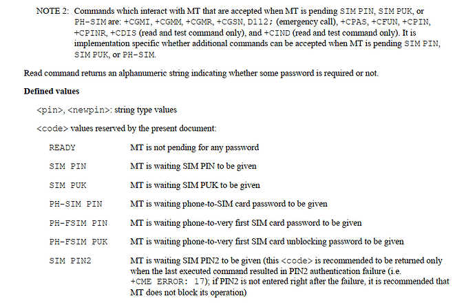

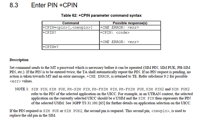

you can use the command AT+CPIN to set PIN code,and to query pin by AT+CPIN?
If you look at the log below, when you set activation(Enable PIN) or deactivation(Disable PIN), the status of “AT+CPIN?” is the same.
Is there something wrong with how I check the status values?
