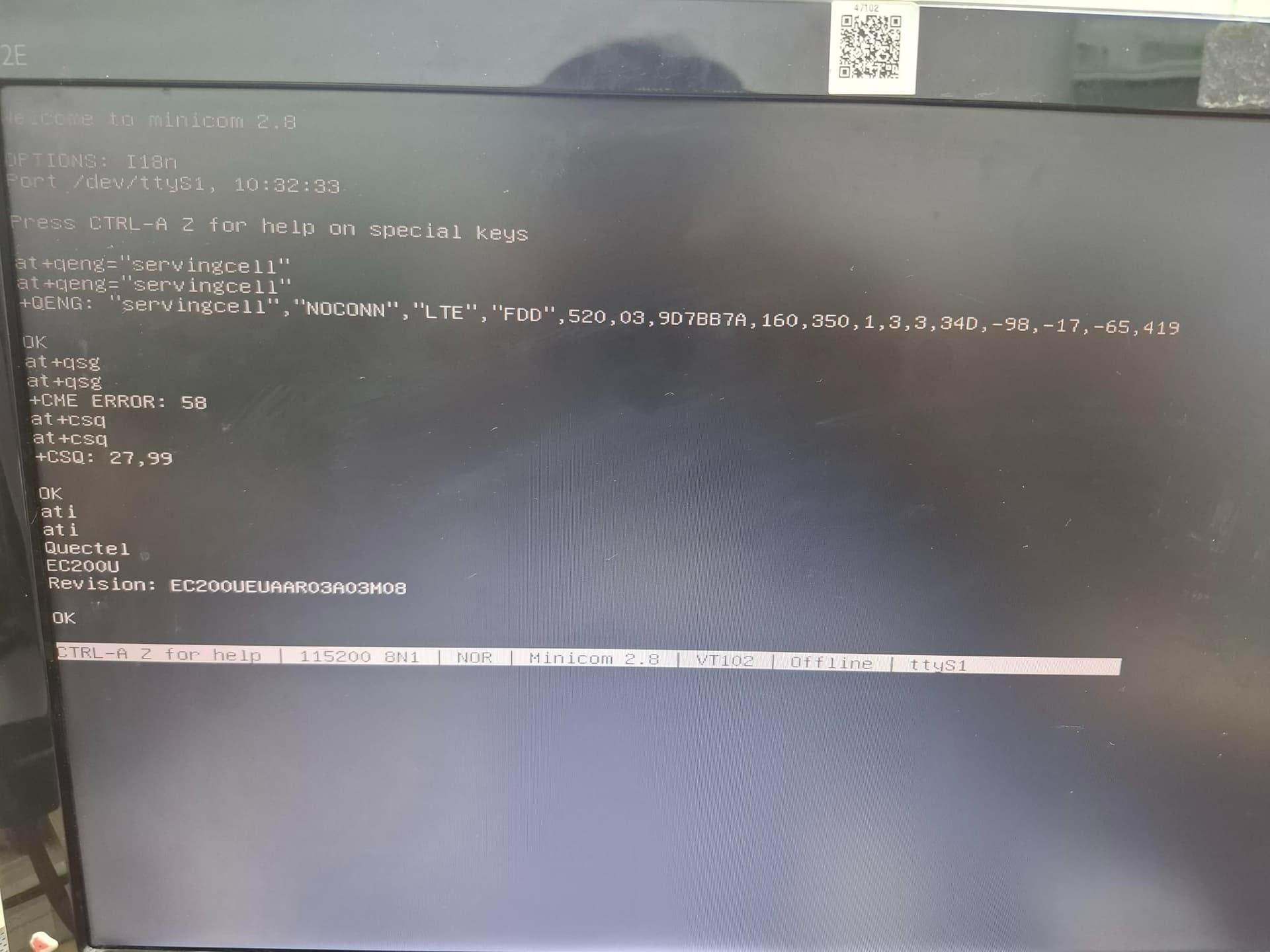

Hi @thana6666
The download rate is not only related to the device Settings, but also greatly related to the wireless environment. Please help to check the AT+QENG=“SERVINGCELL” command and see the return result to confirm whether the wireless environment is good.
