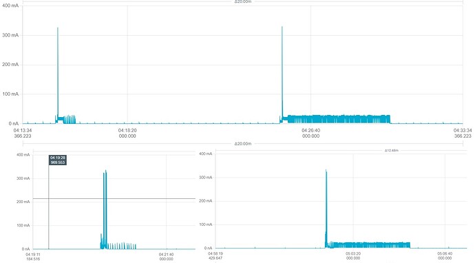

I have been making different measurements of system consumption by logging into PSM and sending messages. I have found that at approximately 4 hours and 30 minutes when a message is sent, the module is active for 5 minutes before going back to PSM.

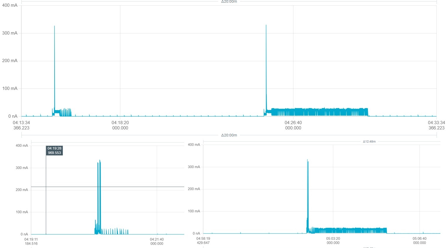

First case: entering and exiting PSM to send messages. The system enters and exits PSM to send data without any problem, the consumption graph is always the same. When the execution approaches 4 hours and a half, when sending data, the module remains active for more than 5 minutes until it enters PSM. (upper image)
Second case: PSM at 4:30 and sending data at 5 hours. I left the system in PSM for 4:30, it woke up and re-entered PSM. After 30 minutes, the process of sending data is carried out and it is when the excessive consumption appears, leaving the module awake until it enters PSM after 5 minutes. (lower image)
Can you help me by indicating what may be the cause of this behaviour?
