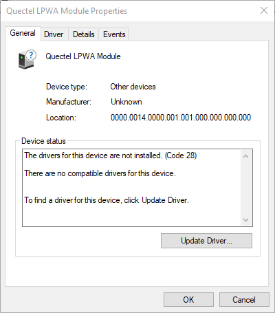

I’m unable to use or install any kind of drivers. I bought the device about 3 weeks ago ant came just in. All I see is “Quectel LPWA Module” in my devices.
Please help?

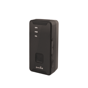

Hi,
Please help?
Yes, that’s the exact device I’m talking about. However I don’t seem to have any kind of drivers for it. All I see is this;
And there is no kind of drivers or anything to be found…
Better contact the producer(support@queclink.com)* who is not quectel, maybe if you publish the “pid & vid” of the sy_manager (see detail,instance) someone of moderators will answer…
Seem BG95-M3 Mini PCIe …
https://www.quectel.com/content/uploads/2024/02/Quectel_Windows_USB_DriverA_Customer_V1.0_EN.zip
but ask support vendor anymore , it has also ubx_gnss chip…
