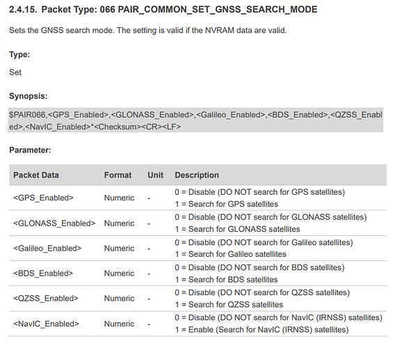

I am trying to connect the L89H module .In the NMEA data the GSV message for Beidou satellites is missing. Is there any commands to enable GBGSV message?
Hi Harshavd06,

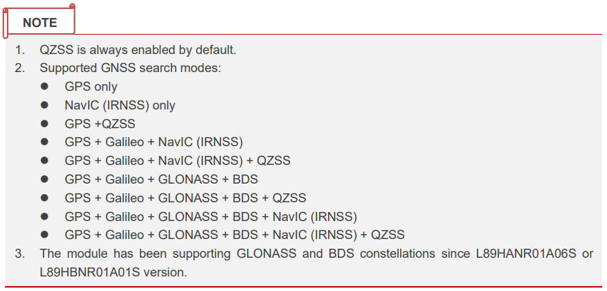

Default constellation on L89H is GPS+Galileo+QZSS+NavIC.
You can enable Beidou searching by sending $PAIR066,1,1,1,1,1,1*3A command.
