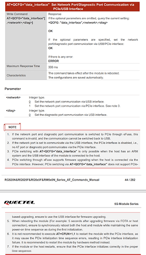

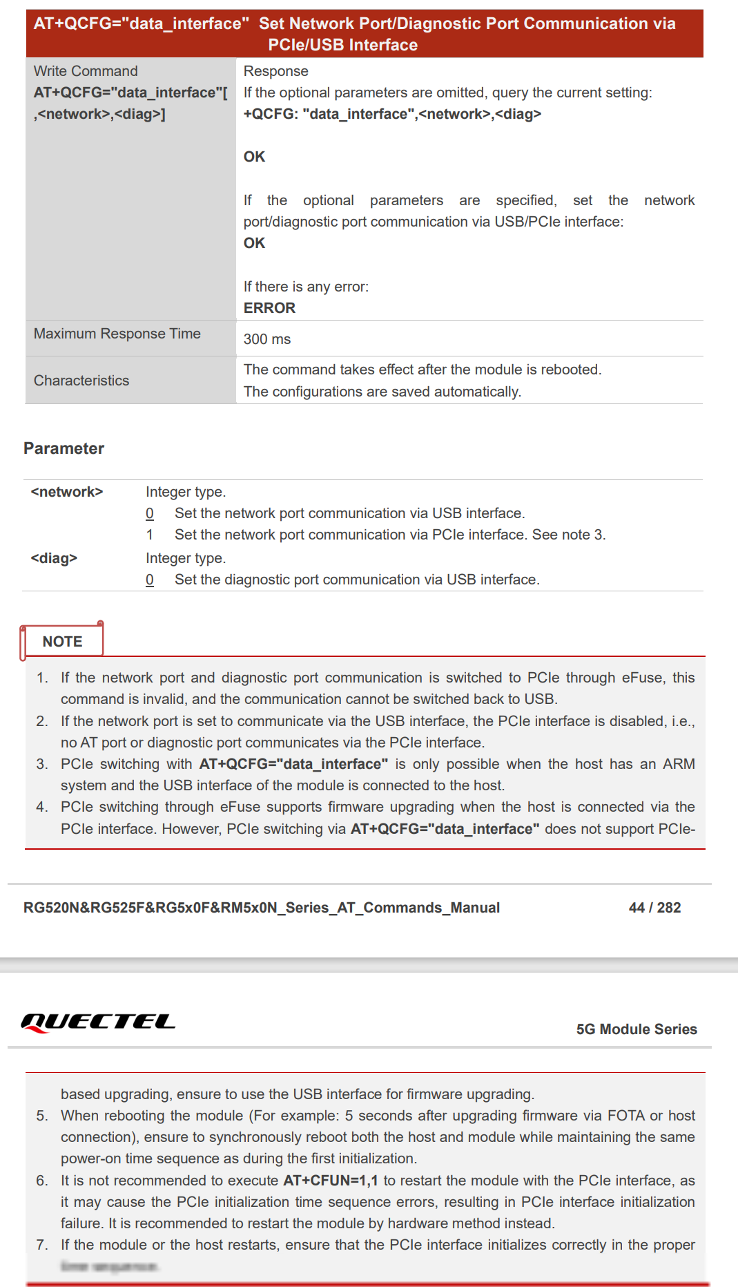

a question:
I’ve check with this comand the PCIE status:
AT+QPCIE="fuse"
+QPCIE: "fuse","disabled"
Does it means that it can run also in USB mode?
thanks!
Dear @elukyan
Flash firmware can’t change configuration of “pcie/mode”.
Dear @stich86
You can use the AT command to check your interface.
But if the efuse is “disabled” does it means that I can switch back to usb?
Because I’ve seen another GLAP module that has the efuse status to enabled
Thanks
Dear @stich86
For MP, it should be efuse enabled.
What do you mean for MP? Multi protocol?
I’m just asking if that output can influence the ability to enable USB mode ![]()
Thanks!
Dear @stich86
You can try to use AT+QCFG= “data_interface”,0,0 to try and see if it switch USB or not.
