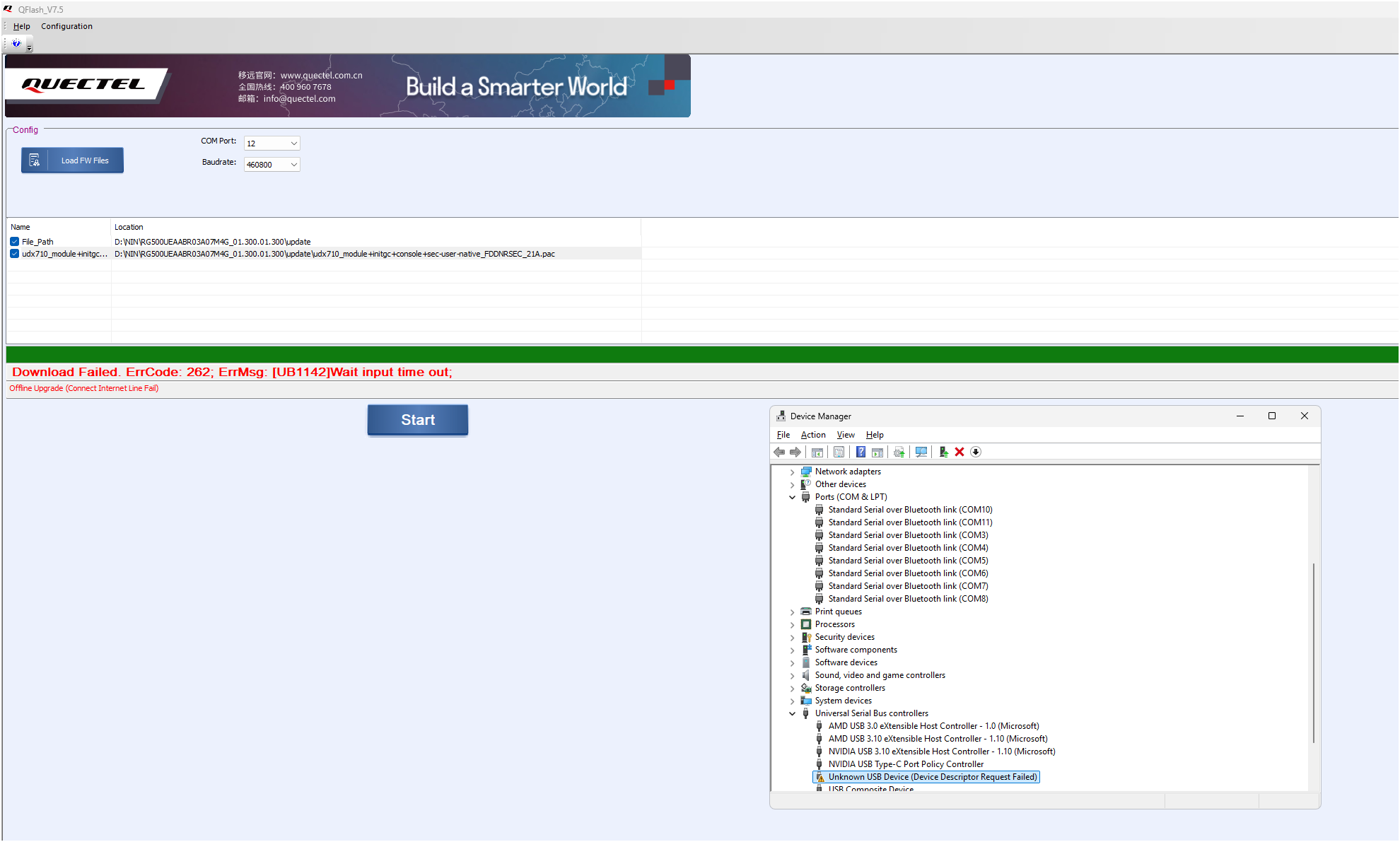

anyone can help/show me how to upgrade using USB mode i keep getting time out and th com port will disappear one it goes to fdl2

Dear @nxixn
Please share a screenshot of the failure phenomenon.

Keep getting error:
Download Failed. ErrCode: 262; ErrMsg: [UB1142]Wait input time out;
Module: RG500U-EA
Router: Tuoshi 5G CPE
SW: RG500UEAABxCOMSLICv3.3.2634.16.16
ATI: Quectel,RG500U-EA,Revision: RG500UEAABR02A01M2G,OK,
Trying to upgrade to RG500UEAABR03A07M4G_01.300.01.300
I think I missing the proper steps how to upgrade correctly. If someone can help out I much appreciate it.
Let me know if further info is needed.
anyone has encountered this and can help me what I am missing with usb mode qflash update. Do I need to short the j021 and usb mode pins to get this working.
I sent AT+QDOWNLOAD=1 and power cycle the router and it detected the com9 port in my PC and I start the flashing fw but it keeps faling at fdl2 and the com port9 disappear in my device manager.

Dear @nxixn
You can move firmware to other disk, not C: and try.
I moved the file to another disk location (D:) but same issue still. I noticed the comport disappers:
Dear @nxixn
Do you install corresponding driver?
yes, used the one in this link
Quectel_Windows_USB_Driver(U)_V1.0_EN
Dear @nxixn
Please share the USB port, screenshot above didn’t show correct port.
It is a CPE device, I am not sure how to operate on your device.
On our side, contact USB to PC and use Qflash, it works fine.
