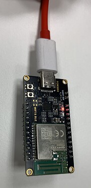

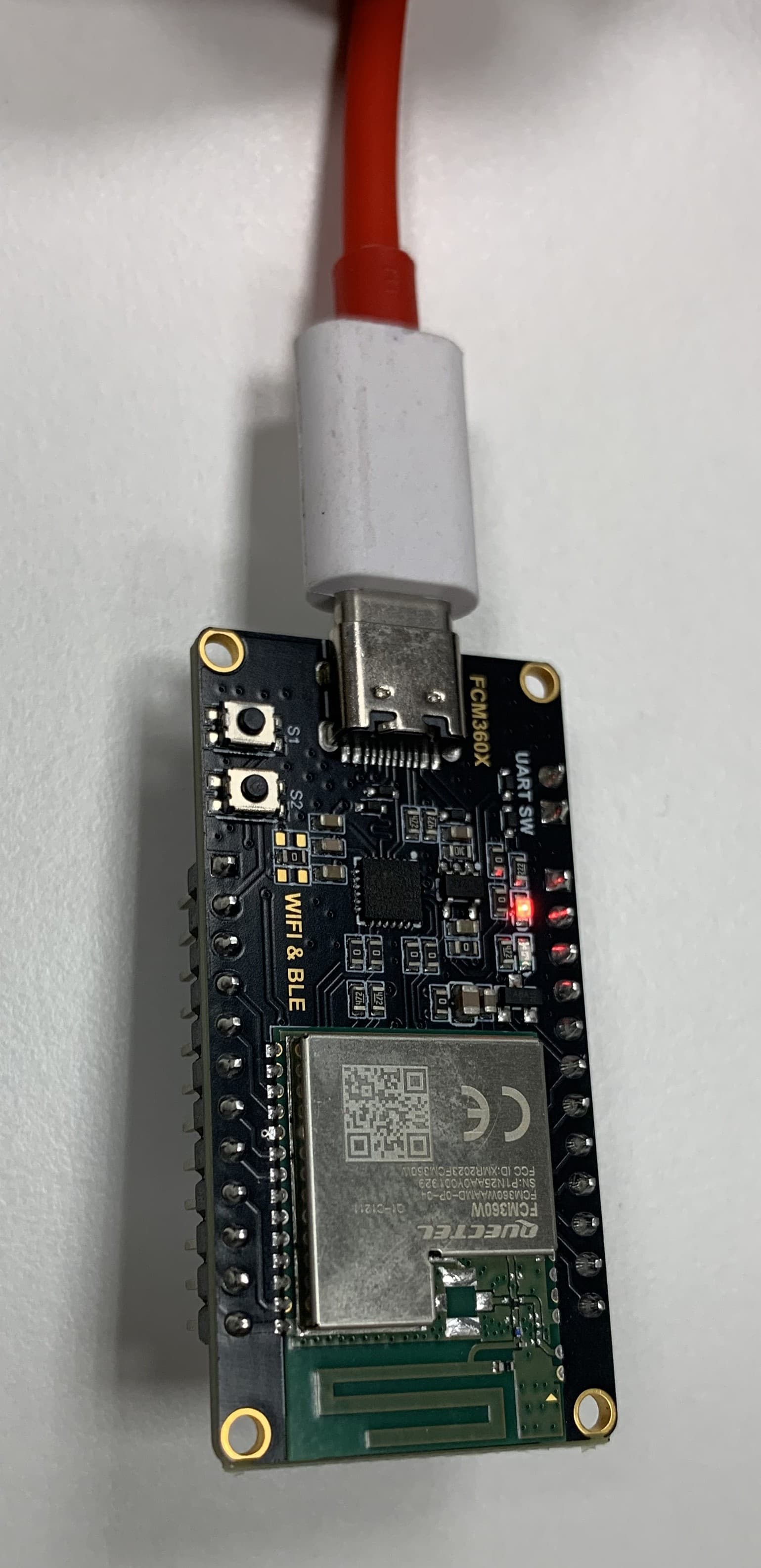

May I ask if you are using a Quectel board for testing? If yes, please take a photo of the board, and I will try to test
Hi Felix,
I’m using the FCM360W EVB for testing, like the attached photo.
