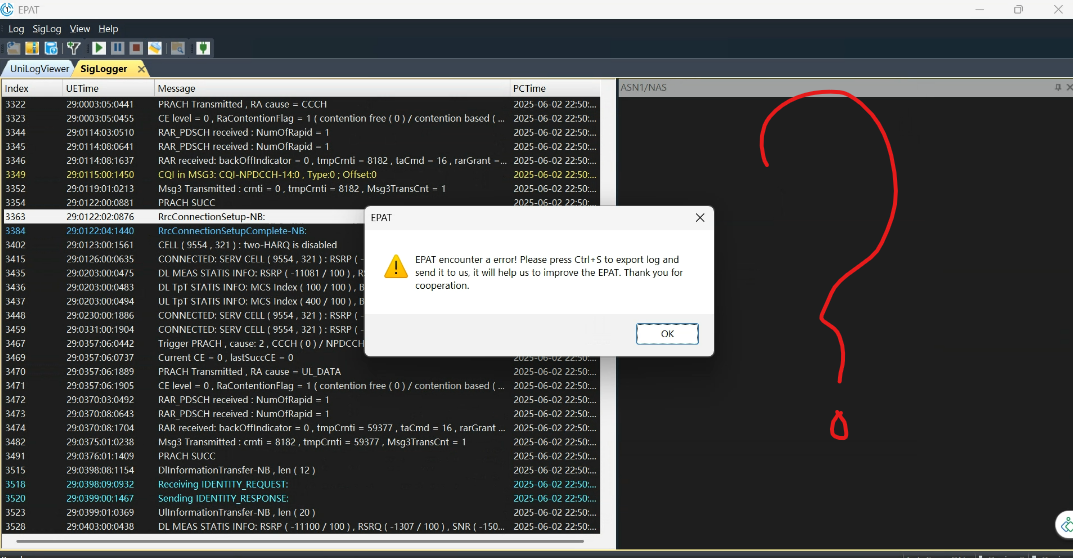

Hi,
While capturing the logs with BC660, i am getting an error and not able to see the message details in ANS1 window.
Can someone help me to identify the issue and if any solution is there.
Hi,
You need to add the installation of the wireshark plugin
Hi, Wireshark was already installed. Issue was with the EPAT version, resolved post installation of latest version of EPAT.
Thank you.
