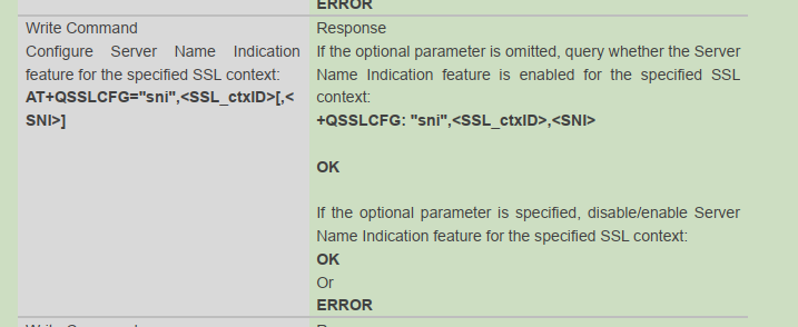

Hi @PratikPatil
Thanks Iyman-Q for reply. I am writing an application on EC200U and would prefer to have c API to configure SNI instead of AT command. Could you please help with the API function for the same?
