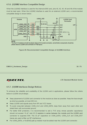

Hi @bogdanov
There has some points to know:
Hi @lyman-Q
Could you elaborate I can see on the sheet you are refering to uSIM (micro SIM)?
I dont have SIM card slot. Laptop is designed without SIM card slot, respectfully it should use eSIM (non physical SIM card ).
