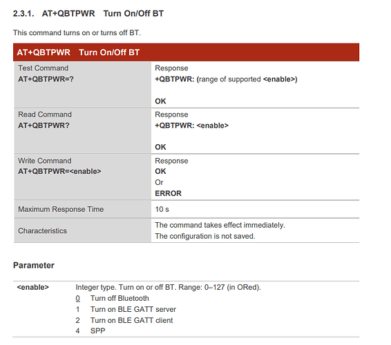

We are planning to use the EG915U-EU in our product, but we also need Bluetooth. I read in the documentation that the chip has optional Bluetooth and WiFi. What does this mean exactly? How should the optional be interpreted and how is Bluetooth accessed in the chip?

Optional means that you can choose this feature when making a purchase. Please refer to the instructions to see if Bluetooth functionality is supported.
