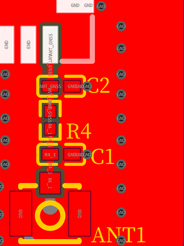

When I examined the “ECx00x&EG800K&EG810M&EG91xN&EG950A Series AT Commands Manual”, I did not see this command. I connect the “YCGO011AA” antenna to the module externally. You can see my antenna connection in the picture below.

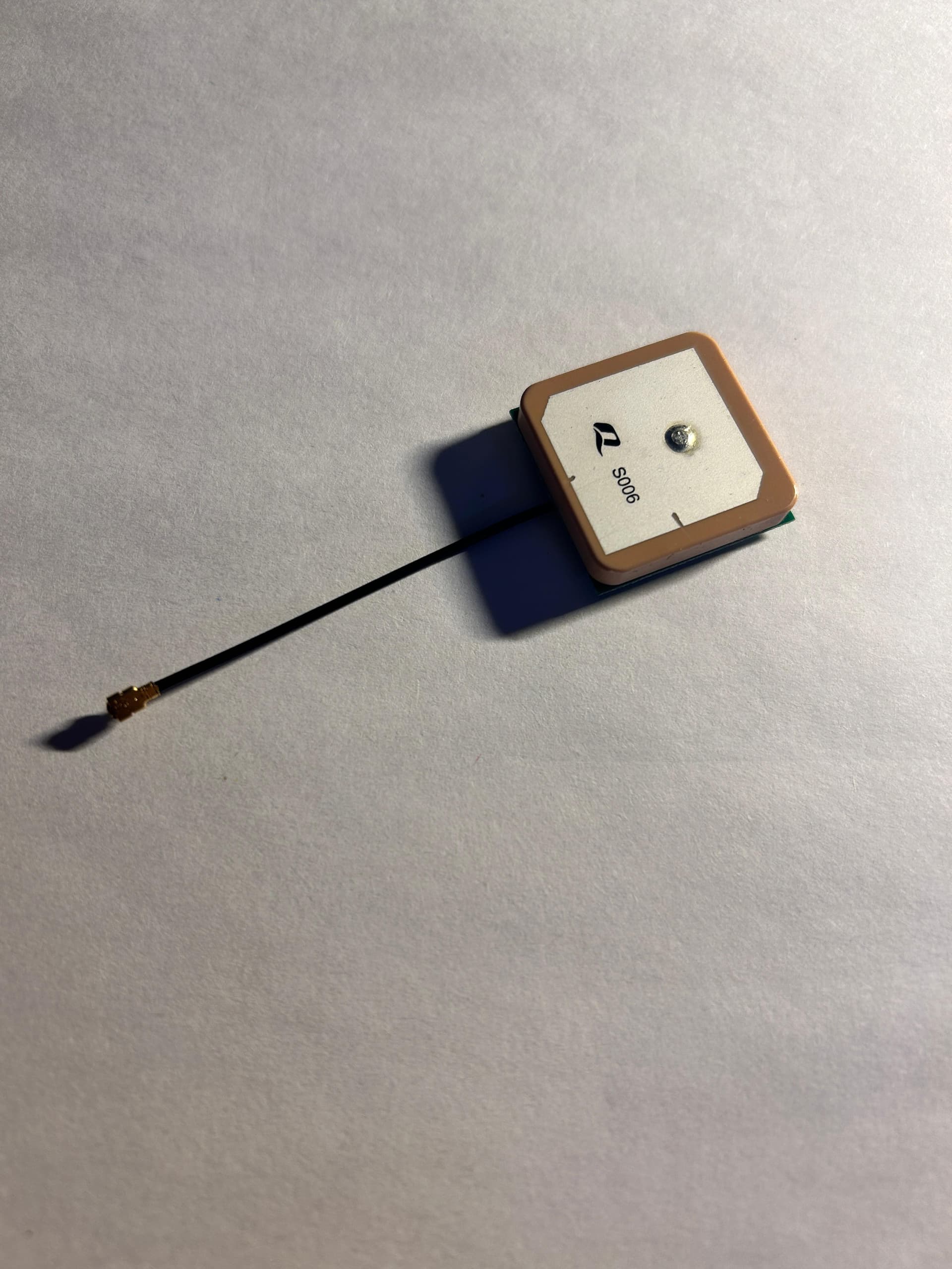

Could you take a picture of the antenna? Is it a passive antenna.
I’m using this antenna.

Have you tested the same location with other devices? I’m still mostly suspicious of the antenna.
I bought a different passive antenna and it worked fine. The problem was the antenna itself. Thank you for your help @Bean.Wang-Q .
