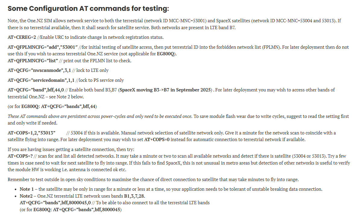

Hi there,
You can refer to the link below on the start up guideline to use the D2C feature.
Getting started with SpaceX over One.NZ – ANZ Team
This SD2C feature is related mainly on the SW part on the module. However, I suggest you to further develop and testing using the D2C OC module such as EG21GGB-MINIPCIE-SD2C. This module will directly include the D2C firmware version.
